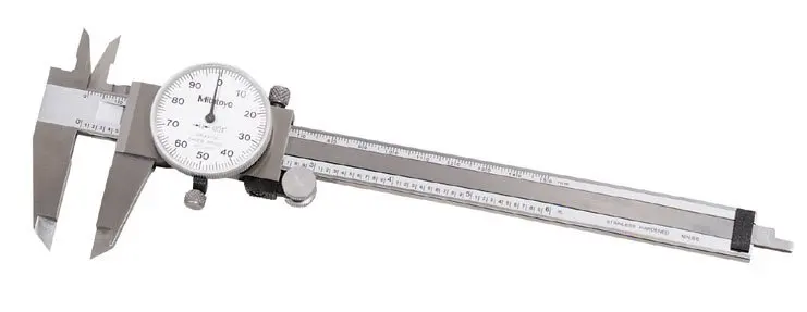

          Originally posted by blockfort
          What do you use to characterize your group's "size" and the accuracy of your rifle?
          Calipers.
          Randall Rausch
          AR work: www.ar15barrels.com
          • #80
            blockfort
            • Oct 2011
            • 1183
            Calipers.
            I didn't ask how you stop your car.
            Sent from my SM-G920V using Tapatalk
            • #81
              ar15barrels
              • 56981
              I have never used these to stop my car:
              Randall Rausch
