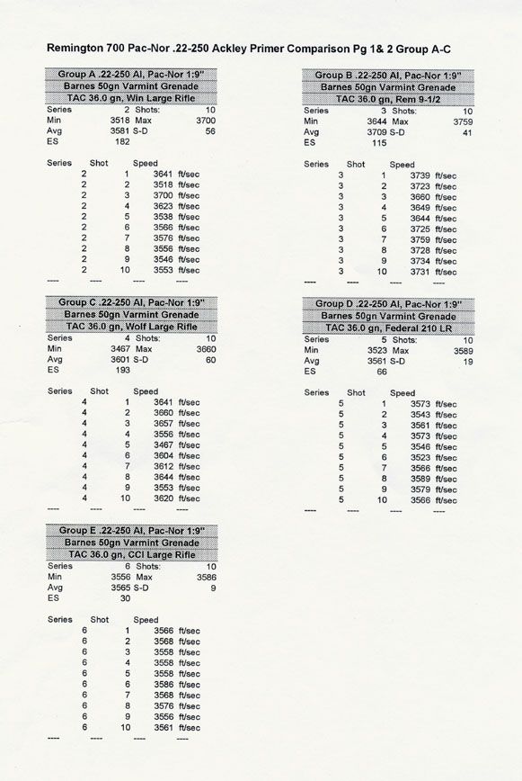

              Magnetospeed was at 99.9% accuracy when compared to photographic measurements. Surprising that they compared their accuracy to another product instead of pointing that out.

                            There are better chronographs than the 35P. Oehler used to make a model 42 with acoustic targets and it will teach you more in one year than a decades worth of shooting. You can find them used for around $2000.
                            Orange
                            I already answered why the Oehler is superior but in case you missed it its called the proof channel.
                            The magnetospeed will give you a larger error but if that isn't important to you it will save you $100.
                            As Robert has posted you can't shoot groups with the magnetospeed because any time you add weight to the barrels muzzle you change its harmonics. That is how tuners work. I will post some pictures of your typical target rifles. One is a typical 22 a typical 600 yard gun and a typical 50 BMG and the magnetospeed doesn't work on any of them. Four typical target rifles.
