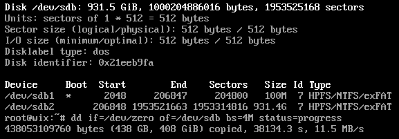

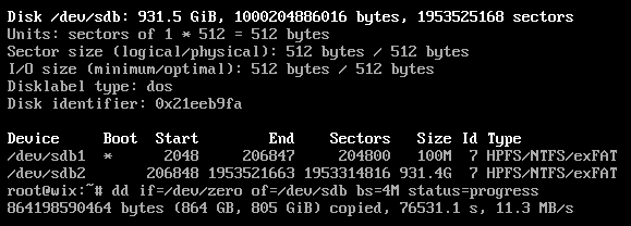

                      What is weird is that the 1TB drive ("newer" drive) is pushing only 11.3MB/Sec, while an OLD beater 40GB 2.5" laptop drive (out of a single-core Gateway Laptop, I think it was) is chooching along at a sustained 20.1MB/Sec, and both are on the same model USB 2.0 "JMicron / JMicron USA USB to ATA/ATAPI bridge" devices, on the same powered USB 3.0 HUB...
                      I DID set the "dd if=/dev/zero of=/dev/sd..." block size of the 1TB drive to 4MB, and the 40GB to 1MB, but in my testing this usually doesn't matter much.
                      Because these are connected via USB I can't check the cache sizes, via CLI.

                            You are better using /dev/urandom than /dev/zero on such an opteration for two reasons:
                            1) /dev/urandom is only about 20% slower than /dev/zero on a 500 MB/s SSD, which would allow you to keep maximum speed in spinning rust, while offering pseudo-random data to write instead of simply zeros, because…
                            2) If you understand magnetic domain recording, you would know that writing a single value, once, over an entire drive allows the complete contents to be resurrected with relative ease. Either multiple passes, or random data are required to impact enough of the magnetic domain to push the average gauss values solidly into one bit or the other. Otherwise, the prior states can be determined, solely by statistical analysis.
                            Another win for SSDs: not only will zero-filling erase all contents permanently, but all I need is a hammer, once, to the logic board, for permanent destruction.
                            Your cheapest and best bet for destroying platter data is renting an industrial shredder.
