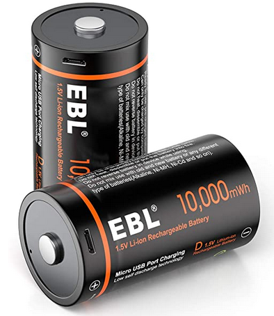

Anyone try "1.5v" "Li-Ion" batteries with a MicroUSB charge port yet?
  • the86d
    • 9587
    Such as these:
    I AM GUESSING that 10000 mWh is a bit exaggerated...

      Maybe someone here can enlighten...why are these rechargeable lithium batts rated in MwH when other lithium like 26650 and 18650 are rated in MaH? Amd how do you compare MwH to MaH?

            A "mWh"includes the voltage in the calculation, why "mAh" does not (it's assumed based on the standard voltage of the particular battery type). mWh is the better number to use when trying to compare energy capacity, kind of like the size of a gas tank. You can calculate the mWh of 18650 lithium-ion batteries by multiplying the mAh by 3.7 (that's the standard voltage of those types). There are some LiFePO4 types and for those you would multiply by 3.2.

              Because, if you use watts, the number is much larger so it appears as if your getting higher capacity but you aren't.

                Wow, those aren't even really batteries.... It's a usb power bank in the shape of a D-cell. Lithium can't produce 1.5 volts. They should print "anti-gravity-battery" on the side too...

                  10 watts hours might be possible since running at such a low voltage. Assuming the battery pack runs internally at 4.2 volts, that puts it in roughly the 2000mAh range. Of course the buck circuit to drop the voltage from 4.2 to 1.5 may be as low as 60% efficient so you might get 1 amp out...

                    Of course the real question, is why. You can get D-cell NiMH with 10 times the capacity for half the price on the same website...
                      EBL NiMH D-cells are 12,000 mWh for $5.66/cell. The Li-ion D-cell is 10,000 mWh for $12/cell.

                        10,000 milli-AMP-hours

                          Yes, and when you convert 10,000 mAh to mWh, it's 12,000. NiMH batteries use a standard voltage of 1.2V.

                              I was wondering how you get 1.5 volts out of a 4.2 volt lithium ion battery.
