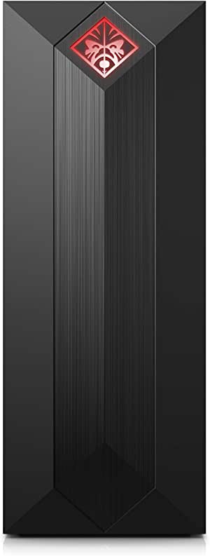

                    Any 800 dollar desktop will do anything him wants.
                    Micro Center HP Omen Obelisk Gaming Desktop: Intel Core i5-9400F, 16GB DDR4, 512GB SSD, GTX 1660 Ti $699.99 https://www.microcenter.com/product/627805/hp-omen-obelisk-gaming-computer
