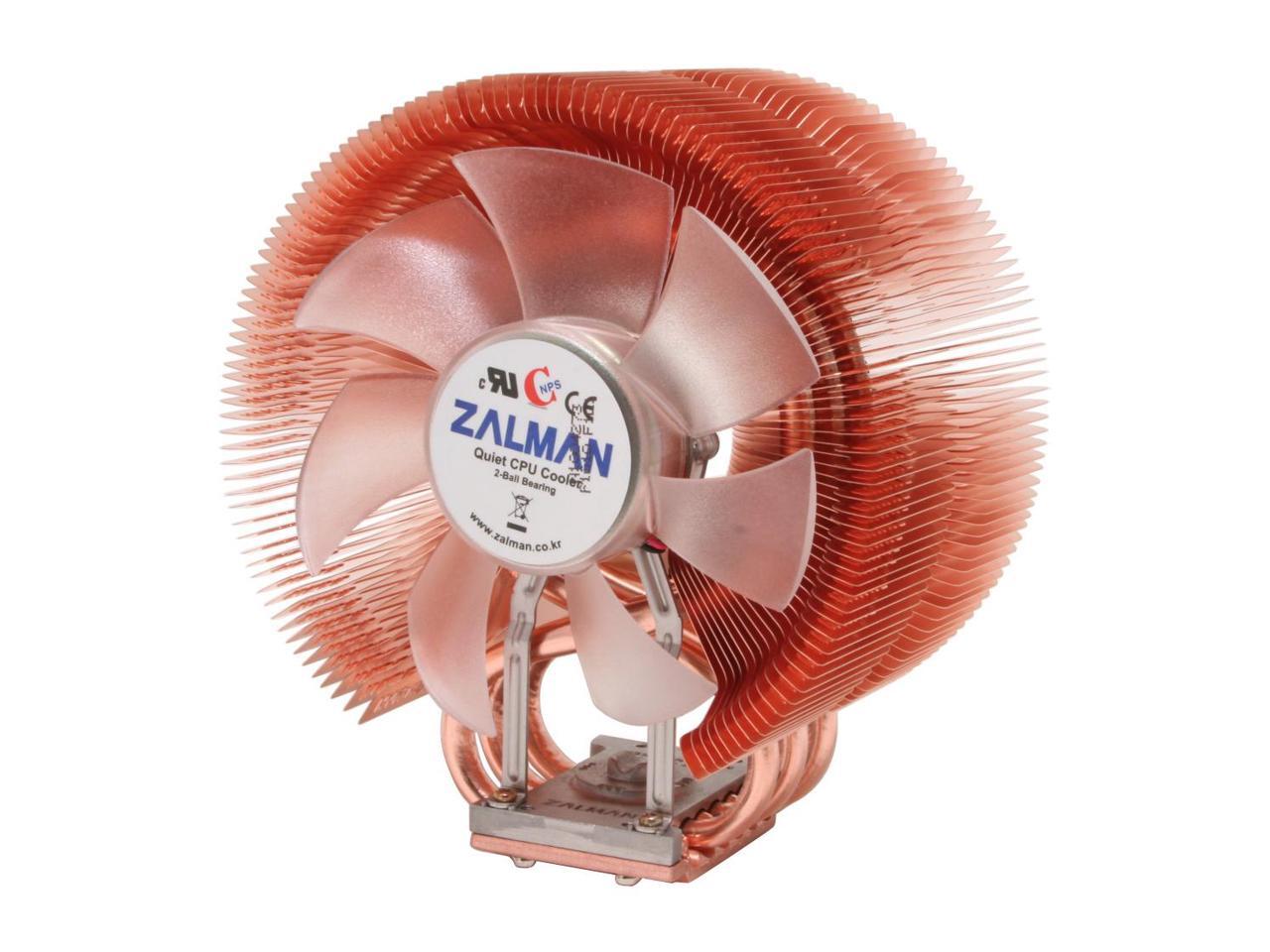

                      This is what I've use on my i7 for the last ~8 years. No issues.
                      Buy ZALMAN CNPS9700 LED 110mm 2 Ball CPU Cooler with fast shipping and top-rated customer service. Once you know, you Newegg!
