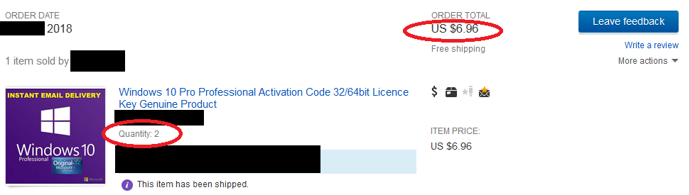

            I just bought 2 keys, myself, off of eBay.
            I don't know if they will work, but you use the ISO/USB created from Microsoft's site to do the install (legit), then use the keys purchased (OEM keys from OEM Vendor? Won't upgrade, but clean install, he says).
            I can't get Windows 10 to see the SSD on my son's T400, or I would verify they work.
            He guarantees they will work, and to contact him if I have any problems.
