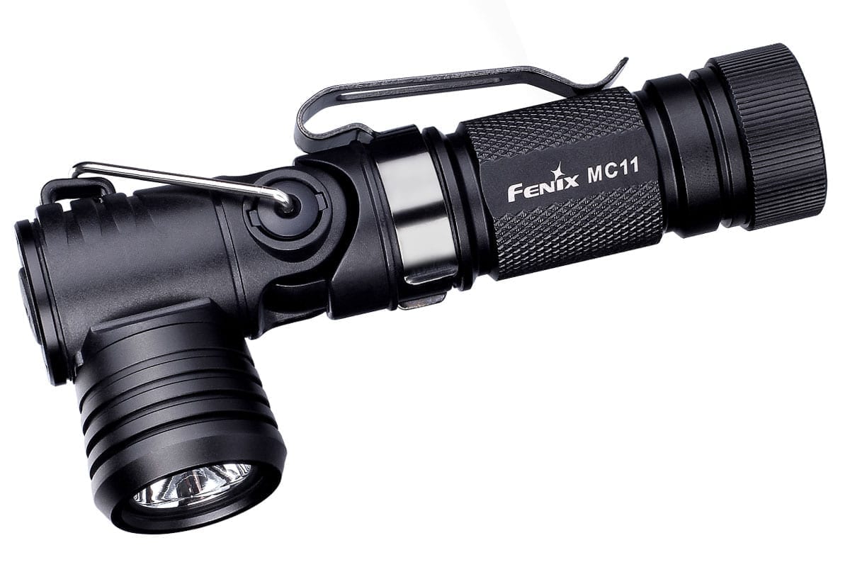

    A proven twist on reliable Fenix flashlight performance, MC11 turns any direction that light’s needed. Favorite among trade professionals & recreational users.
