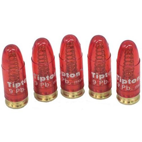

      I like the Tipton Snapcaps. Good for all kinds of training including dry firing and FTF and FTE drills.

        ^^ those look of high quality.
        and I can advise something you might already know.
        the type that are inexpensive, hard plastic, orange & a one piece design, they might be OK for a few uses but the rims on my older versions of that type always broke off when a metal extractor grabs them.
        ( .. then you could just use them to try some " clear the major malfunction" drills.)

                        I've had those tipton style ones break on me. +1 for the A-Zoom dummies.

                            I like the Tiptons because the primer is spring loaded so it puts less stress on the firing pin.
