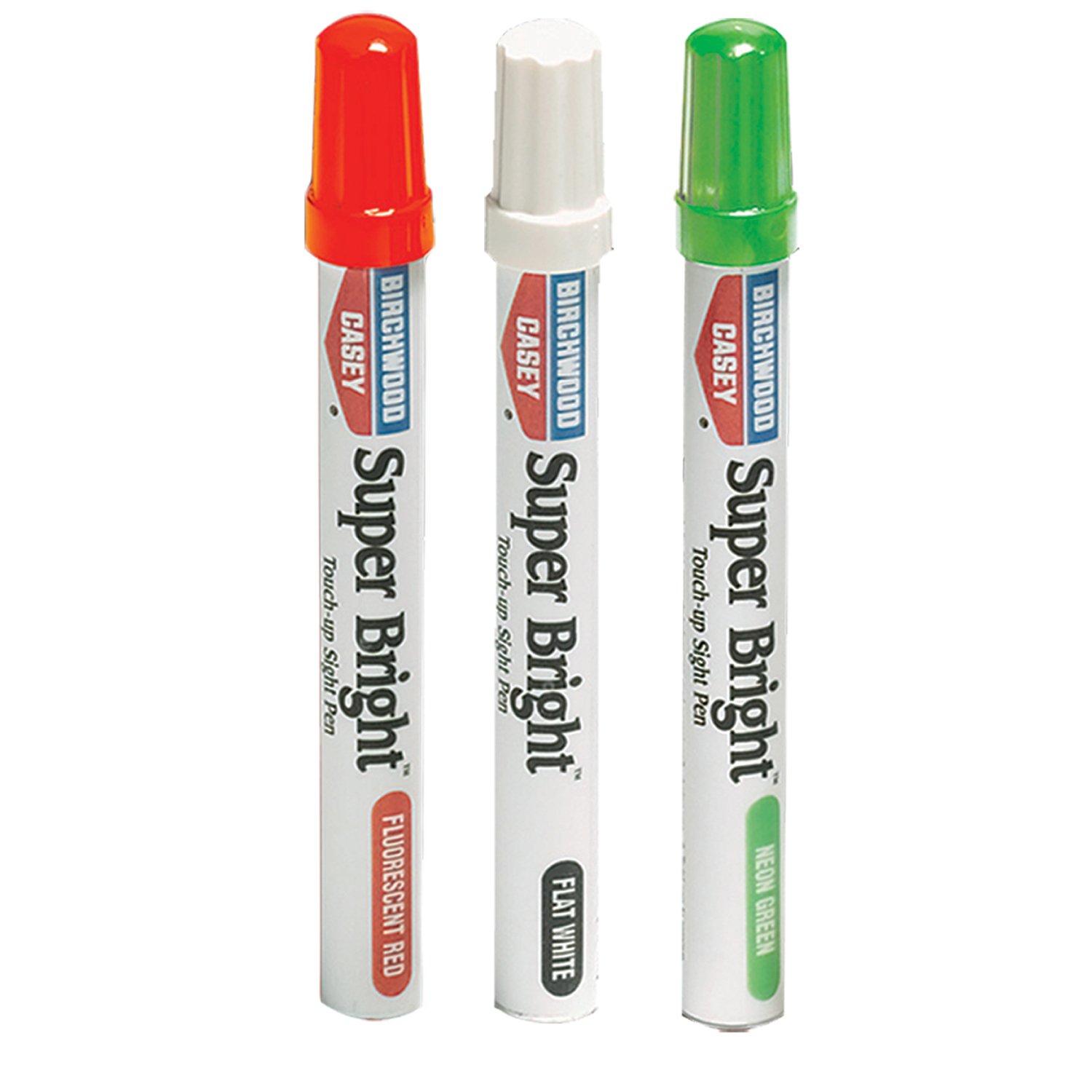

                  Finger nail polish works well, you can find some pretty bright colors. I used a bright, almost flourescent yellow/green polish on the front sight of me SP101 3" 357. That helped a lot.

                      Shop gunsmithing tools (604) at Brownells, including bench blocks, hammer & punch sets, screwdrivers, and tool kits for firearm maintenance and repairs.
                      last one
