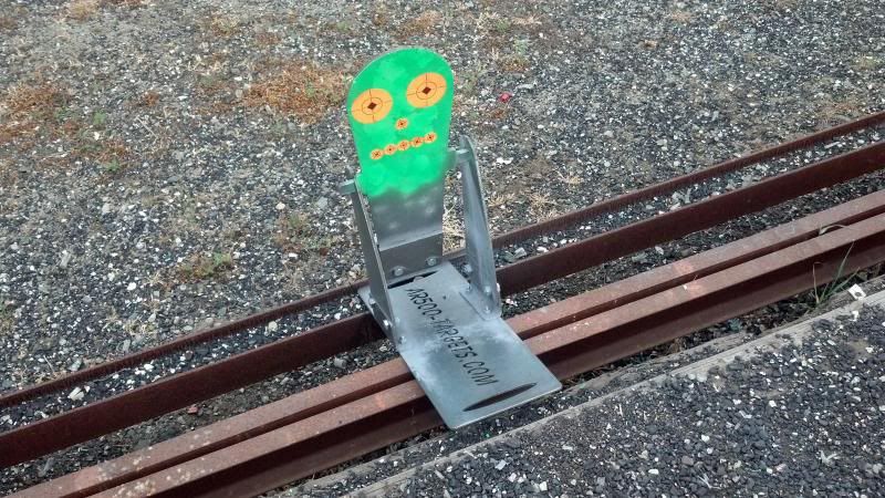

    I bought a couple of those tumbler targets over a year ago and had great results with them so I went kind of crazy and ordered another $400 worth of targets, including a long range flopper that cost almost $200. I've taken it out to the range a total of 4 times and would be guessing the high round count as 100 rounds. Here's a pic of the target set up at the MP range at USI:
    Last weekend at the Nor Cal C&R shoot in Oroville, we had just set the target up at around 100 yds and my Son shot it with his 30-06 using HP Match bullets and blew the arm off it, which really sucks because it makes it pretty much worthless now. I've never tried to drill this stuff and I imagine it's not any fun. I'm thinking if I can get another piece of 1" wide stock I could bolt it across and make a new pivot for this thing.
    What do the metal gods say?
    Here's the broken piece:

    On a serious note, have a welder fix that for you. Bolting something together sounds like a PITA.

        get another piece to weld on and go by a muffler shop and see if he will weld it on for you. take cash. something small like that, muffler shops are usually cheaper than welding shops.

                  I would consider having a piece of flatbar welded across the back at those arm locations too to give it some more thickness. Even though it's AR500, that little tab area is gonna be weaker when it takes a hard hit because their is less area to spread and dissipate the energy over. Plus it would strengthen the repaired area which would also be weaker anyway.

                    THAT is a dumb design for a target... Do you have welding stuff etc? With this high carbon, welding can be tricky. You might try brazing a new piece on. If you are having to have a shop do it, they'll know of course. But don't give up, it can be fixed!

                      I would think that you could make a new piece of metal that is the same width as the target from outer arm to outer arm and then plasma cut two holes in the shoulder.
                      Cut off both original arms/ rotational axis
                      Then bolt the new plate behind the good arm all the way across to the bad arm.

                          Yeah that's kind of what I am thinking too. If I can get a piece of 1/2" AR500, I could make a new pivot and hopefully it will hold up.
                          This thing was a blast when it was working. I shot it with my SVT40 and it actually swung all the way around once! It barely had any pock marks at all because of the fact that it swings to cushion the blow a little.
                          I got a PM from someone who is a welder, so I will try to get it fixed.
