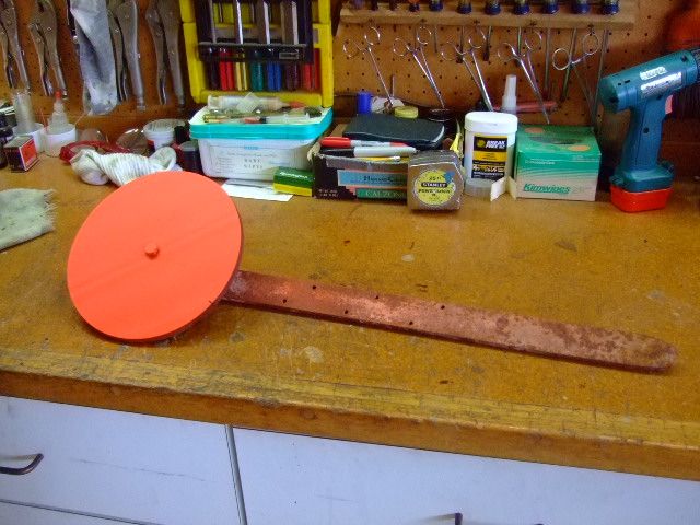

If you want cheap steel targets, here's my version:
I got an iron form board stake from home depot for about $3, drilled a hole in it, and mounted an 8" diameter round 3/8" plate to it with a bolt and a spring:
[IMG]

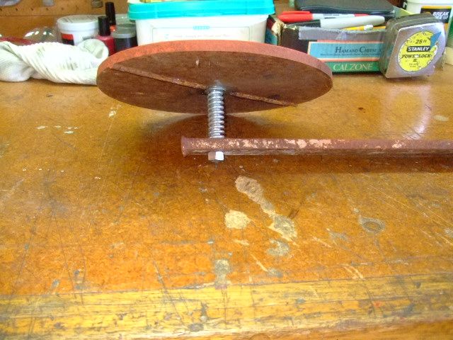

The bolt is long, and there is a spring behind the bolt that absorbs some of the energy and lets the round "wobble" when hit:

Just hammer the pointed end into the ground and your set. Only disappoinment with this is the sound. If you just thump the steel or tap it with a pencil or something, it rings like a school bell. But when hit with a projectile, it just goes "klunk".Tire kickers gonna kick,

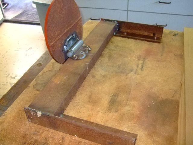

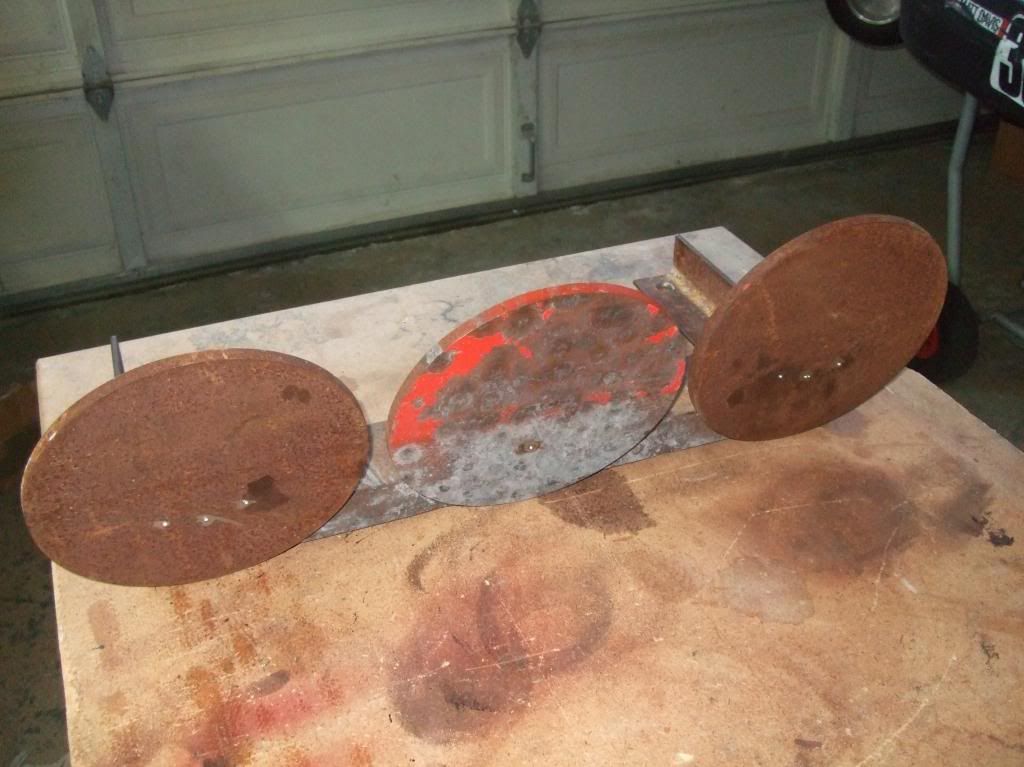

More DIY steel..here is my flipper steel. this is more complicated, requiring some steel cutting and welding to make the frame, and some drilling and tapping to mount the hinges:
[IMG]
[/IMG]
The round plates are mounted on heavy duty spring loaded door hinges. Occansionally, they get bent a llittle and have to be hammered straight after a day of shooting, but it holds up to the beating it takes.
[IMG]
[/IMG]
I anchor the frame to the ground with four short pieces of rebar used as iron nailsTire kickers gonna kick,
