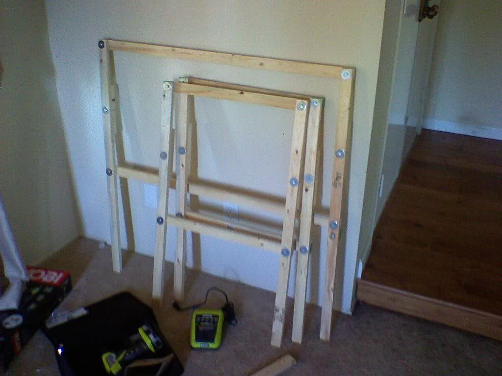

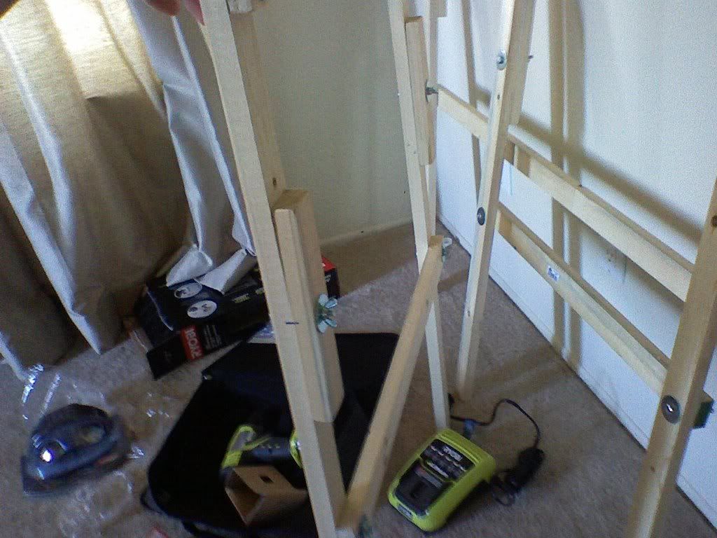

    I have been trying to shoot paper targets that have not been attached too a box. So I built target frames that I can quickly disassemble and put together with no tools and while being able to fit it in my car with ammo and rifles. It also has strips of wood with a bolt to hold down the cardboard so i don't have to staple it to the wood allowing longer use of the frame as long as I don't shoot it. anyways here are the pics.

    I do the same design, but with PVC pipes. I don't use and glue so you can dismantle and stow. Those are very nice.

      Very nice construction, but try not to hit those bolts and washers with anything high power. You will most likely find them 20yrds down range with a gaping hole in your frame. Also, you will want to use caution if you do any close quarter drills with pistols, again those bolts/washers can cause back splash of lead/copper if hit.

          I wanted to stay away from pvc because of if that gets hit and shatters and somehow I get hit with it i'de rather pull splinters vs pieces of pvc out of me. Plus it was simpler. and the wood on bottom going across lets the cardboard rest on it.

                  I don't use screws due to i want to assemble it really quick with no tools, and use cardboard to go across the empty space, so I can staple or tape my targets on. and wood ease of repair ect.

                              But its not as cool if I didnt put any effort into it. plus to buy the wood, screws and wingnuts to build 3 of them cost 16 bucks. yes I may have saved a bit but I built these for being I know they will fit in my car. now only if I can build me some steel plate targets.....
