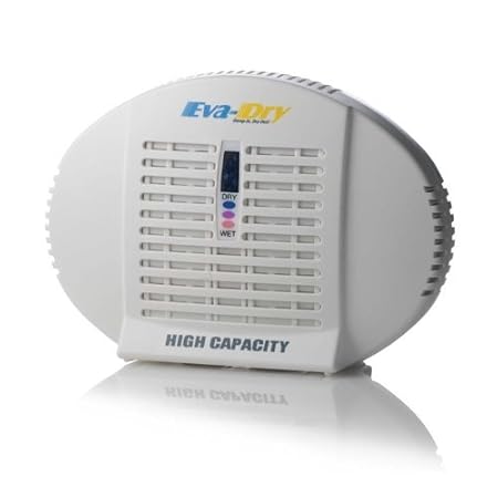

                          I use Eva-Dry E-500 high capacity renewable dehumidifiers. Once the beads turn color you just plug it in over night and it's ready to go again. What you want to avoid is DampRid because it's corrosive if you spill any.

                            A while back, I found quite a bit of surface rust on my 870, but luckily it came right off with a little oil. I started using the 280 gram disposable silica containers, but still felt compelled to inspect everything at least once a week. That got real old real quick. After about 2 weeks of the Eva-dry E-500 and the disposable silica container, I'm averaging between 44% - 52% humidity. Love the hygrometer with daily highs/lows. Now, i just check the meter once a day at most, and as long as my high reading is <60%, I just lock the safe back up and don't give it a second thought. If I had access to an outlet near my safe, I'd run a goldenrod as well, but I don't, and also don't mind the fact that I don't have to drill a hole in my safe to run power to it.
