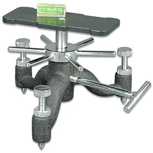

    This one looks interesting, dirt cheap, and potentially hold up to a lot of abuse

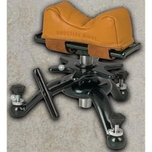

    This one seems like a pretty decent quality rest with a lot of features in it for the money. A bit more money than the others but I don't mind spending a few bucks for quality. Money is tight right now or I'd buy the $150 caldwell that I want!

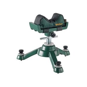

    And this last one seems decent, looks well made and I can get the rest and bag for around $50 or so. I've never had any experience with the company, nor could I find any real reviews on it. Anybody dealt with them before?
