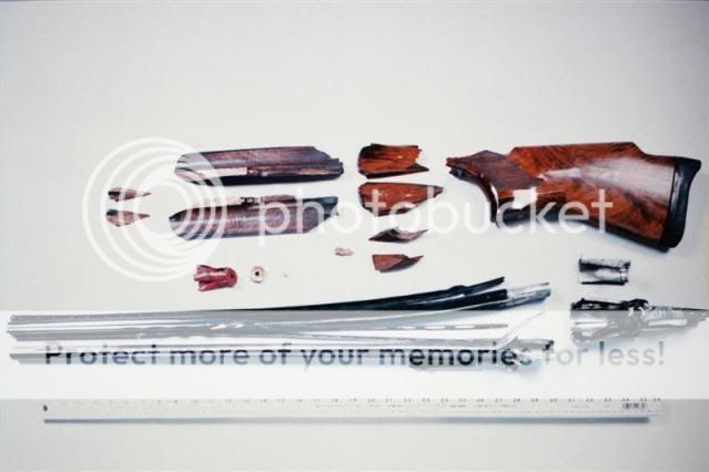

        Pictures:
        • #34
          BroncoBob
          • 6019
          Pictures of that shotgun don't look good. Hope he recovers.

              Damn that looks nuts. How's his recovery?

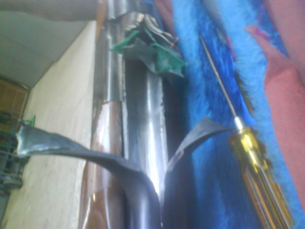

                Originally posted by AdamM
                I actually know the person that this happened to.
                What happened is he had purchased a Remington O/U (Not sure of the model) and wanted a single barrel for it as the double was too heavy for trap. He had a single barrel made for the gun and was working up a load for Olympic Bunker and double charged it. When it went off it blew through the top of the chamber and cut the top of his forearm and another piece of metal went through his wrist and out of his elbow
                From your photos it was the top chamber that blew up. Also from your photo of the rib it looks like this was set up as an unsingle - lower barrel fires only and the top barrel should be plugged. Was this the modified single barrel that blew? If it was it looks like the plug may have come out of the top barrel.
                Over charging I can understand, double charging I can't - it just uses too much room in the hull. Besides double charging a shotgun shell is one heck of a lot of powder. It seems there had to be a blockage to cause so much damage.
                Hope your friend is ok.
                Jack
