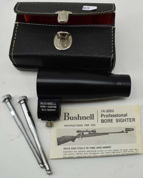

        Took me 3 shots last Wednesday to zero a newly mounted scope after bore sighting with a Bushnell Professional Bore Sighter which is the old-school optical collimator type with bore arbors which I’ve been using for 30+ years. Bushnell makes a magnetic bore sighter that you just place on the barrel face and there are laser bore sighters too and other less mechanically calculated ways to save time and get you on the target.
        1 shot at 50 yards and 2 shots at 100 and I was in the X, first shot was 6 inches high and 2 inches to the right.
