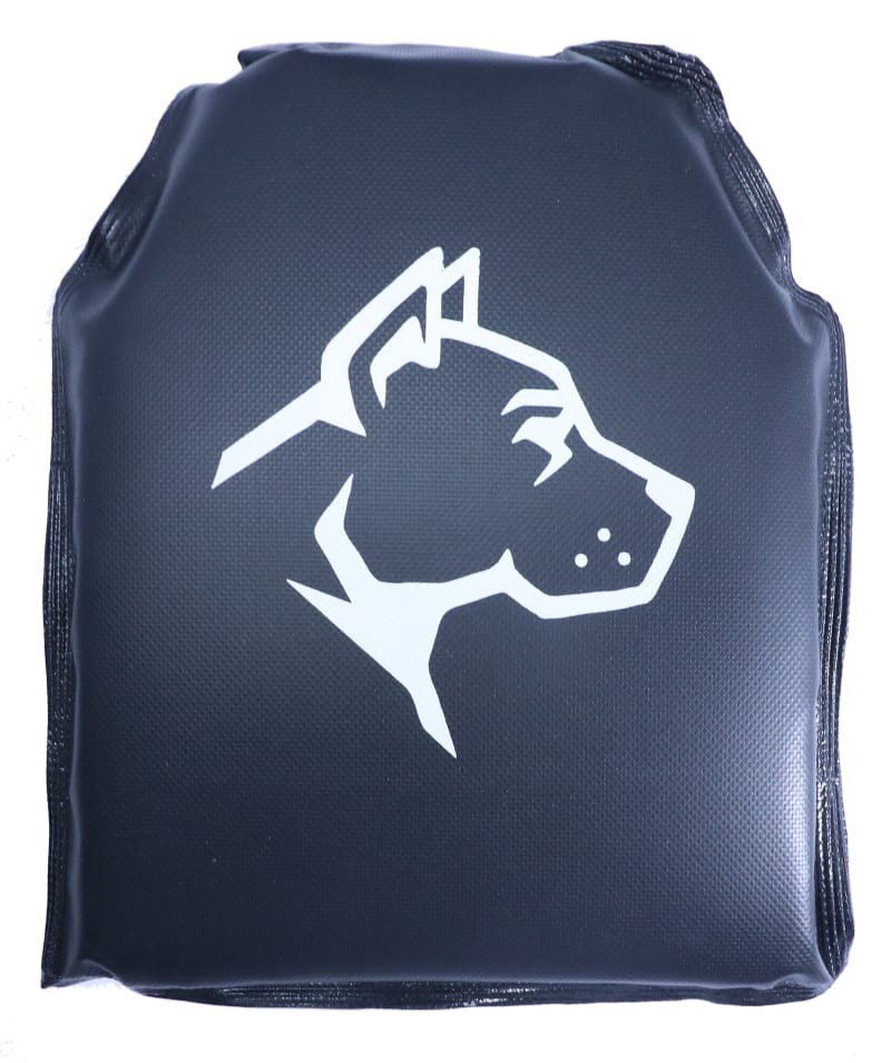

                  Here's something much cheaper. It looks somewhat thicker than what I posted above, and it looks like it needs to go in a carrier of some sort, but concealable plate carriers exist. On the plus side, it's rated III+, which means .308, and it's much cheaper, although that means it's chinese.
                  Guard Dog Body Armor VERSA: The Guard Dog Body Armor Versa plate is the latest addition to the Guard Dog Body Armor line-up. This revolutionary Versa plate features flex technology that allows the plate to conform to the wearer's body, maximizing comfort during prolonged use. In addition, this Versa plate is incredibly lightweight and weighs in at an astonishing 5lbs per plate. This Versa plate has been extensively tested and meets NIJ Level 3 and 3+ standards WITHOUT additional armor or a 3a backer. No other plate on the market brings this much versatility, comfort, or protection to the table. If you are looking for the ultimate multi-hit rated lightweight armor package then look no further...Please see the testing specifications below.  Testing Specifications: 7.62x51NATO, 147-grain M80 FMJ at 2750ft/s. 5.56x45mm, 62-grain M855 Green Tip at 3000ft/s NOTE - Sold Individually. If you would like to order a pair simply selectQTY (2).

                        Originally posted by db556762
                        https://www.highcomarmor.com/why-sof...-rifle-rounds/
                        You won't stop 308 with soft armor.
                        Horsecrap. The post I made has III+ armor, III is .308.
                          ar15barrels
                          • 57193
                          Sorta...
                          Level/Type III Body Armor
                          Level III body armor is stronger than Level IIIA because it defeats rifle caliber rounds. Level III will always have a hard plate insert that must be tested in a conditioned state.
                          The NIJ tests Level III conditioned armor against a 7.62mm FMJ (M80 military) weighing 147 grain and a muzzle velocity of 2,780 ft/s. A 7.62x39mm FMJ is normally fired from an AK-47 style rifle.
                          This ensures Level III armor will stop a 5.56mm FMJ bullet fired from the most common AR-15 models.
                          Level III flexible armor is required to be tested in both new and conditioned state to get a complete understanding of its capabilities.
                          They test flexible armor with the same specs (147 grain, 2,780 ft/s, and 7.62mm) as the hard plate.
                          The biggest difference is the flexible armor must be tested with the hard armor.
                          Make sure you understand that flexible armor rated at a Level III will not stop a 7.62mm (.308) bullet without the hard armor insert.
                          The NIJ will not approve of any flexible armor replacing a hard plate unless there are at least 2 flexible plates with each other.
