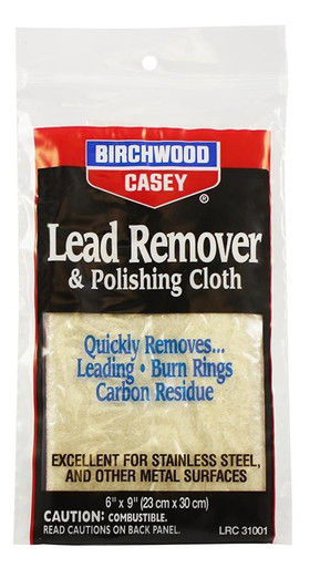

    Been shooting lead last couple months
    If you are shooting lead- you really need something designed to remove lead...
    birtchwood casey lead removal cloth
    it's kind of waxey
    cut a patch out of the sheet
    run it down the barrel
    repeat until clean
    (thanks to Jeff Cooper)

      BIRCHWOOD CASEY Lead Remover&Polishing Cloth 6INx9IN - BC-31002 - Cleaning Products - Buy online hunting and shooting gears, firearm accessories and more at Safari Firearms.
