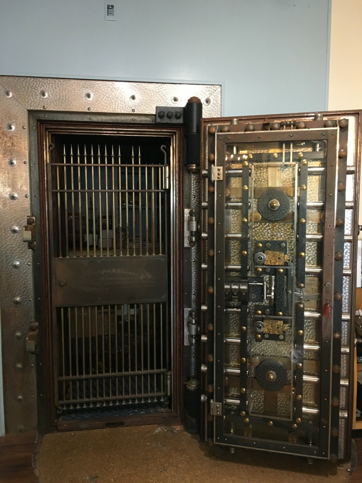

                                My old house was cement filled Rebar enforceed Cinderblock. The old man who built it put in a crude home made safe door. Outside looked great but the concealed hinges and lock mech was pretty janky but worked.
                                Ended up cleaning up the hinges and lock and used it 10 years.
