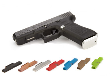

      Shop the Glock Gen 1–6 Extended Slide Lock Lever at NDZ Performance. Improve control and simplify takedown with a precision-crafted, USA-made upgrade.

            The extended slide lock lever does help, it's worth the $10 price.

                  As others have said the extended slide lock lever helps quite a bit. I put it on all three of my Glocks and I would do the same if I bought another one. It's easy to do but watch a couple of videos first.

                        Yes, those are the basic steps for removing the slide but the stock slide lock lever is almost flush. It is very easy for one side or the other to slip out from under your thumb or index finger. The extended lever is cheap, easy to install and has never slipped out from under my fingers. It works first time every time.

                          My friend replaced the takedown tab to an extended one, some people have different fingers I guess. I have to admit, sometimes it takes a few tries for me too but I've only had my 19 for a few months and have never cleaned it.

                              I found it a major pain, on my Glock 19... could never seem to get a grip on the take down tabs!
                              As others have mentioned, you can purchase extended take down tabs from Glockstore and other places for something like $12... once I purchased an extended take down tab, and replaced it, it has been easy peezy ever since!
                              YouTube have simple videos of how to exchange the take down tab! Worth a try!
