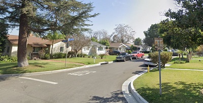

    Unless I am misunderstanding some nuances/details in the video, I am now unsure of a good HD scenario setup in a single-family residence, single floor, sub-urban setting, etc. Something like this (random photo):
    Assuming JHP defense rounds - 9mm, 45ACP, .223 and 12-ga 00 - considering the WORST case scenario where there will be rounds that will miss, would the handgun rounds be the less risky of them?

      That is the concern I now have (after watching Harrell's video)...
      My house is built such that if the confrontation would happen in the kitchen/dining room or the living room, the only barrier would be the exterior wall. From the living room, it would be the main street with 4-lanes to the opposite house. From the kitchen/dining room, it will be the window, then the fence, then the exterior wall of the neighboring house.
      If the confrontation would happen in the master bedroom (chokepoint for the criminal) - I would have better luck that no overpenetration happens. A shot from my position in the bed to a criminal in the hallway would even avoid the kids' room; while encountering many 'barries/walls.'
      Thinking about this (I hope I am NOT over analyzing it, though) - my best bet would be to stick with handgun defense rounds. Unless of course, the neighbors have been infected with the T-virus, er, W-virus.
