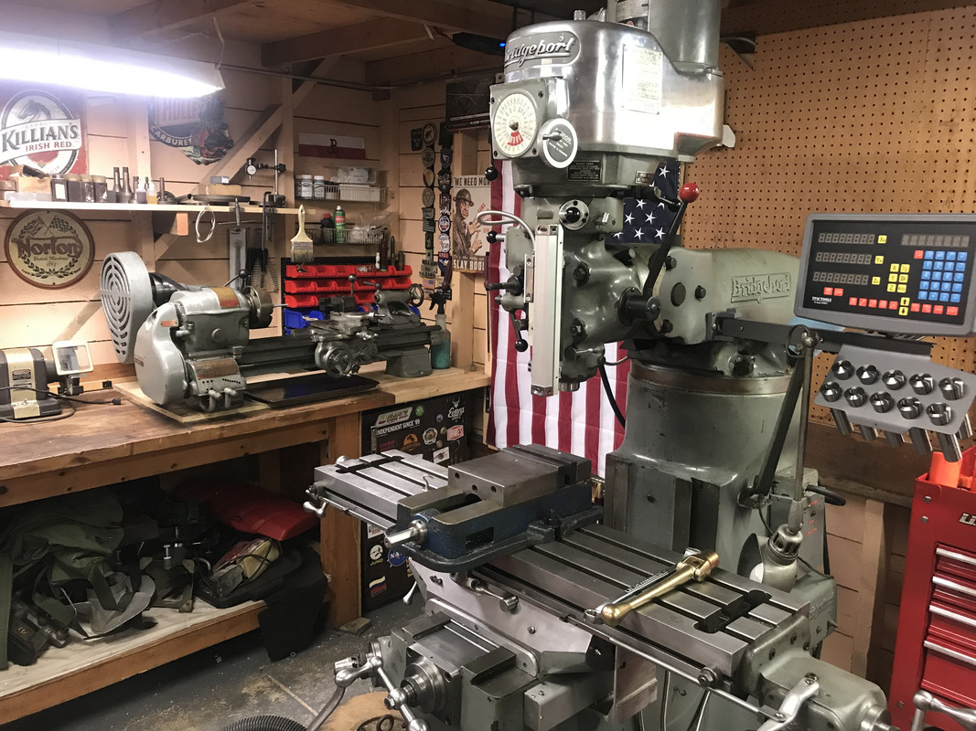

                  Here's what I got, had them for more than a couple of decades.
                  I've had a CNC, fun, but need to have a purpose.
                  Good luck with whatever you decide.

                      Nice setup Cuda!

                        Nice sharp machine Cuda. I used to visit them often when I was in different department. Thyy do make pretty good manual mahhines.

                                Thanks for posting the picture. Worth a thousand words.
                                Shows how much room and rigidity/weight/mass is needed to mount a vise for work holding. That makes a world of difference when your mill is chewing steel which in turn allows for accurate cutting.
