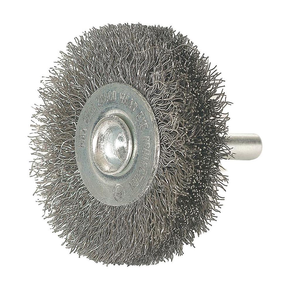

                    The Gleam
                    • 11290
                    You could try this.... however, might remove the bluing.
