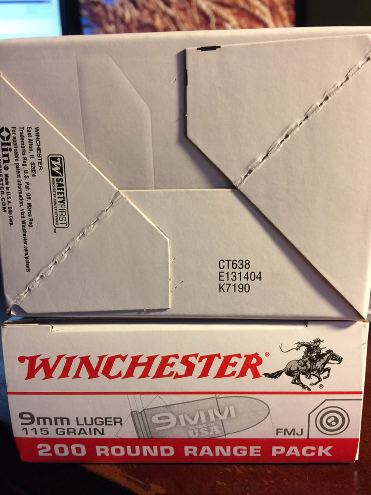

    Glad your are ok. Weird you had two in 200. Can you post the lot number?

      This was all I could find on the box that could be a lot number. Though I think this is package identifying information. There was nothing that looked like a lot number printed after the box was originally inked for marketing.
      There were two, 100 round, all-white boxes (top) in the bigger box. The 100 round white boxes had nothing different printed on them either.

        Look inside the box. Sometimes it's printed on the inside.

          Contact Winchester. Save the box and whatever rounds you have left over.
