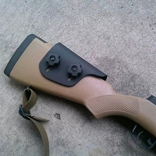

    and the kydex ones like this:
    Is one preferable over the other? I'm not too fond of the idea of drilling holes through my stock, even though it's just the normal factory stock. I'm hoping to hear from some of you experts.

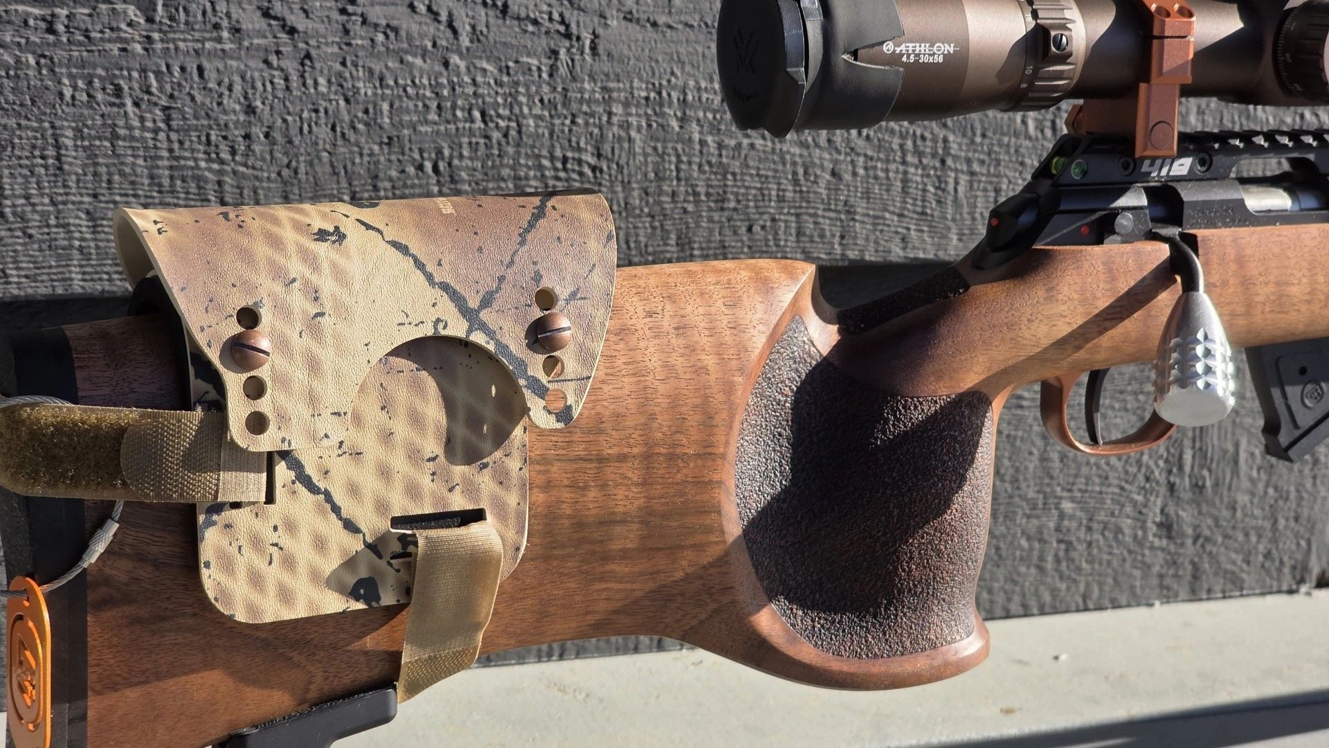

                  44mm objective. I'm using talley medium rings. I might be able to use the small rings, but I'm not sure if that would bring the scope down to the height I'm looking for. Here's my setup:

                    Lower rings may help some but make sure the handle wont hit your scope.
                    I have the Triad pad and its really nice. Comes with Velcro inserts to build up as a riser but on your stock, I'd look at getting the Triad and building it up with a good dense foam like pool noodle or foam pipe insulation.

                      The first thing I would do is lower the scope.
                      If you have the factory rings put them on. They work just fine for both of my Tikka's and I have shot many, many rounds in each rifle.

                            Yup- scope is too high.
                            Always mount the scope as low as possible.
                            Any stock pack will work just fine. A very common material under the pack to raise the height is an old mouse pad- wetsuit material. However many layers you need under the stock pack to get the height you want. I know one guy that carved a soft wood block under his.. maybe some people are using their wifes maxi pads.... But.. mouse pad/wetsuit foam is very common for this.
