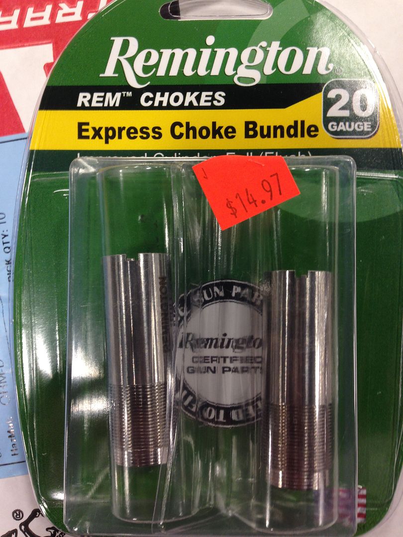

          Well today I headed over to Gander to grab chokes and they ended up having that combo pack
          For some reason it was on a clearance rack for $15
          Snagged it

                Gander doesnt make sense
                They had a single flush fitting Remchoke in Full for $20
                I got the bundle for $15

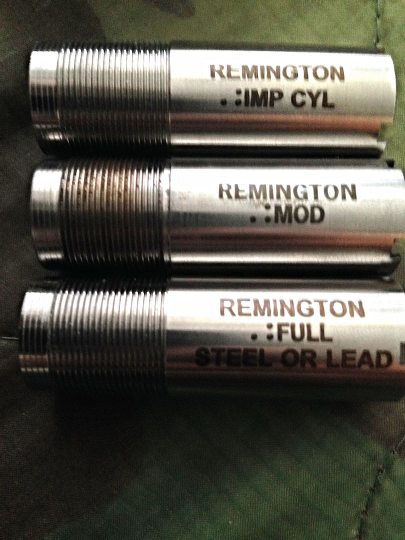

                  Heres all three chokes
                  All made from the same material, all have that 3 dot pattern
                  Only the full is marked Steel or Lead

                    -just to make sure, you understand that lead shot acts very differently going through a choke than steel shot.
                    So a modified choke using lead shot will "act" like a modified choke, where the same choke will "act" like a full choke for steel shot. Some chokes will have two markings, one for lead shot and one for steel shot. So notice that a full choke for lead is too tight to be used for steel shot.

                      So running steel through Full choke would be too restrictive?

                        For some chokes, yes, but there are full chokes that are rated for steel. Call the manufacturer and ask. Much safer than trusting someone on the internet... unless it just so happens to be a company rep. :P I know my Carlson's extended Invector+ tube is rated for steel. And a lot of guys will use a bigger shot size when switching over from lead to steel. Maybe one or two sizes up.

                          According to Remington all Rem-choke are rated for lead or steel.......................BUT they recommend nothing tighter then mod for steel.
                          *Figure one size difference between lead and steel: a Mod choke will pattern like a full with steel shot and so on.

                            The cheapest Ive seen a single Remchoke from an online retailer is $15
                            So I got 2 for the price of 1 essentially, couldnt pass that up
                            That makes sense on going one size smaller with steel
