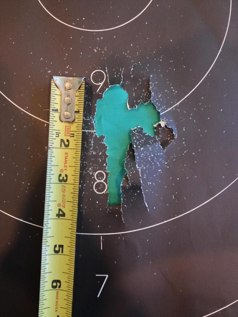

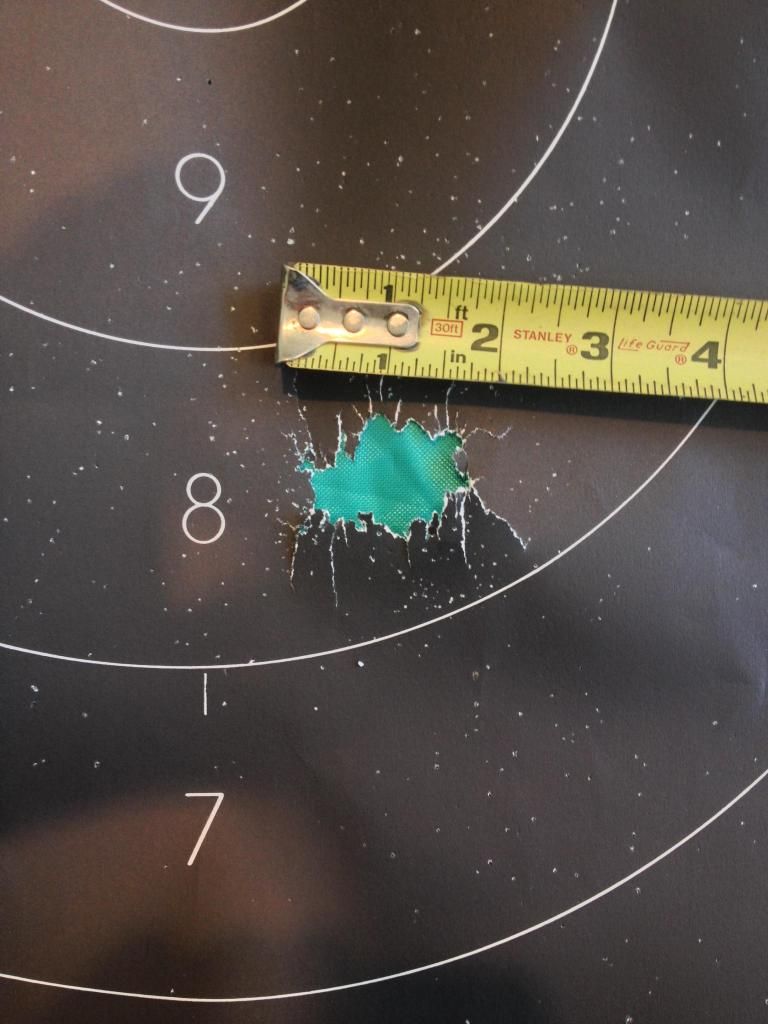

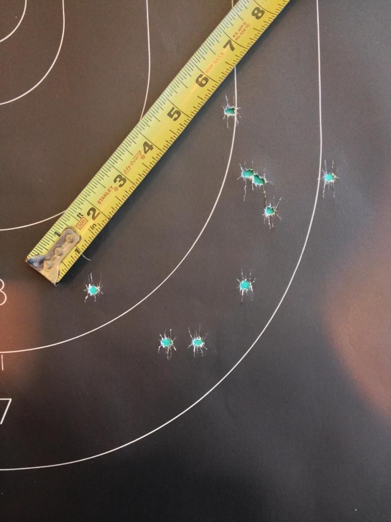

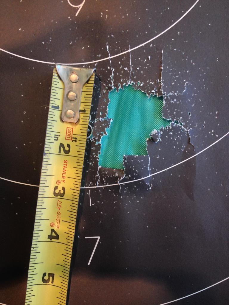

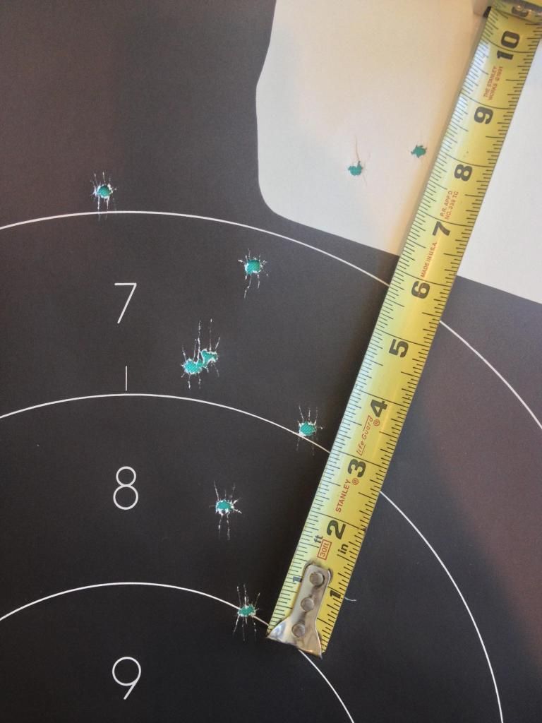

    Took out my trusty 870 that serves as my HD gun. (18.5 inch barrel with Improved Cylinder choke)
    Ammo used was Federal LE Flitecontrol 9 pellet - 00 Buck reduced recoil 1145fps. (LE132 00)
    Distances were shot at 3, 7, 10, 15, 20, and 25 yards. I was pretty impressed by the tight patterns, especially the pattern at 15 yards. Just goes to show that you can achieve very good patterns without the use of "tactical" chokes. The Flitecontrol wad has thoroughly impressed me. Results are below.
    3 yards
    7 yards
    10 yards
    15 yards
    20 yards
    25 yards

    15 to 20yds it sure does open up. Good stuff!

      Very cool! You can really see how it starts falling apart/spreading out @ 20yds. I'm going to need to pattern my HD gun now
