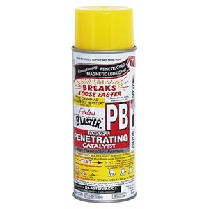

    If you don't have one pick up a can of PB Blaster and soak they up pretty good, should loosen them up and make for easy removal.

      "PB" ??? say what?

            PB Blaster...similar to but more effective than Liquid Wrench, WD-40, etc.
            OP, I'd soak the business end of the barrels for a day in a can of PB, obviously as deep as the chokes are long.
            Then remove the barrels, wipe off any residual PB, and heat the barrels in the choke thread area with a heat gun...I don't think a hair dryer will do.
            Use a dab of Never-Seez when you reassemble.
            hth
