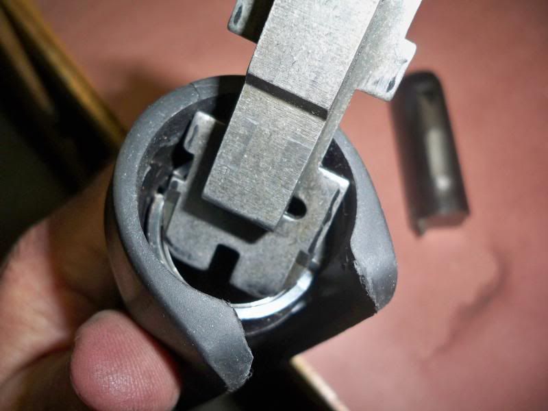

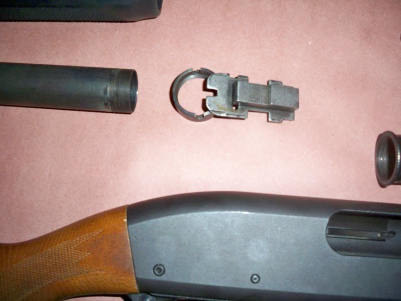

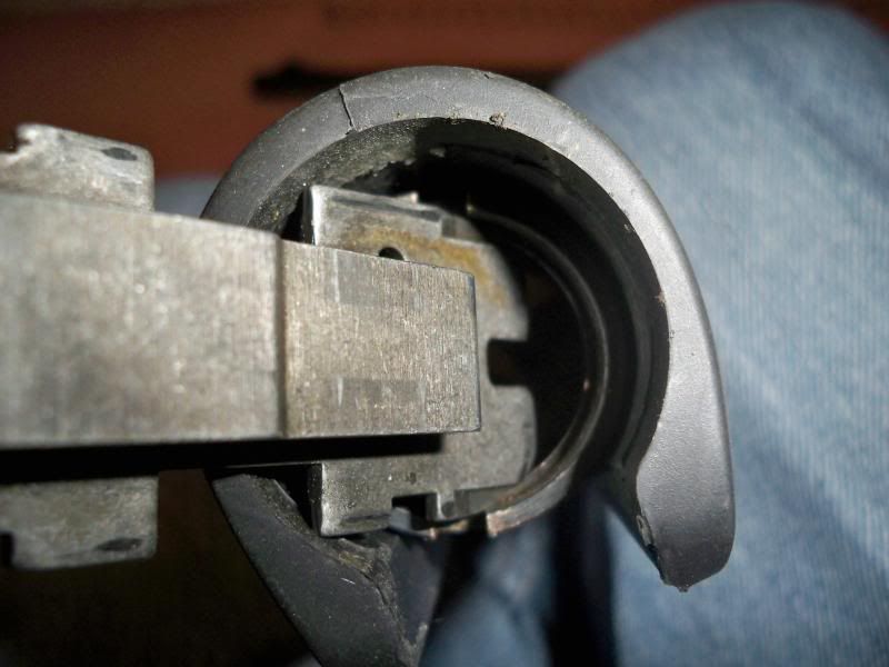

              Once at my LGS shooting the breeze, the owner said some years ago the gunsmith told him that they should give away dremel tools! I had to try your idea and here are the pics. By jingy, it works!

                  But you're using the wrong end of the slide. The other ends fits the forend tube nut perfectly.
                      [IMG][/IMG]
                      Thanks
