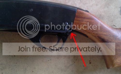

    I have never owned a shotgun before so I have two questions for you guys. First, please tell me what the proper terminology is for this button:
    I got this Savage Arms model 69RXL Series "E" 12 gauge from a family member that has been just sitting in storage for many years. Apparently some idiot had attempted to fire a 20 gauge shell out of it. The shell was jammed into the throat of the barrel at a 45 degree angle and busted open spilling out the pellets. I didn't think to take a picture at the time so I recreated the situation as best I could in this photo:
    I removed the jammed shell, took the gun apart, cleaned the internals, and reassembled. I have taken it out twice since and it fired. Problem I am having is with the fore end jamming hard in the forward extended position. The only way that I can cycle it to load the next shell is by holding the "release button" (the one in the top photo) and jamming the buttstock down on the table with good amount of force. I have used these two different types of shells so far:
    With the Winchester shells its jamming in between shots about 30% of the time and with the other stuff it jams nearly every time. Any thoughts as to what may be causing this?

    I consider the button just a bolt release. But as far as the jamming could the round have bent the barrel to a point it shifts when a shot is fired ?
    Maybe a picture of internals can show any burrs or bare metal that could be the culprit

                            hermosabeach
                            • 19895
                            I am on my computer tonight, not my phone.
                            It looks like the first picture shows that the receiver cracked/ sheared off a piece at the slide release. Am I seeing the issue correctly?

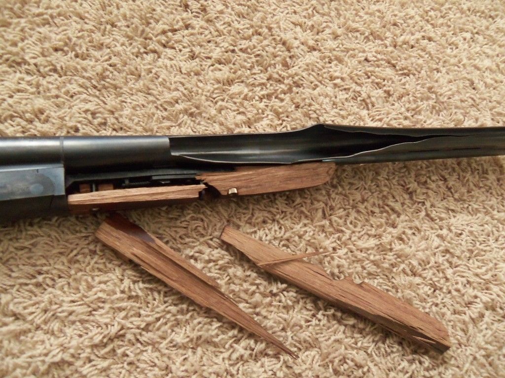

                            and now some scary pictures
                            (thanks to Jeff Cooper)
