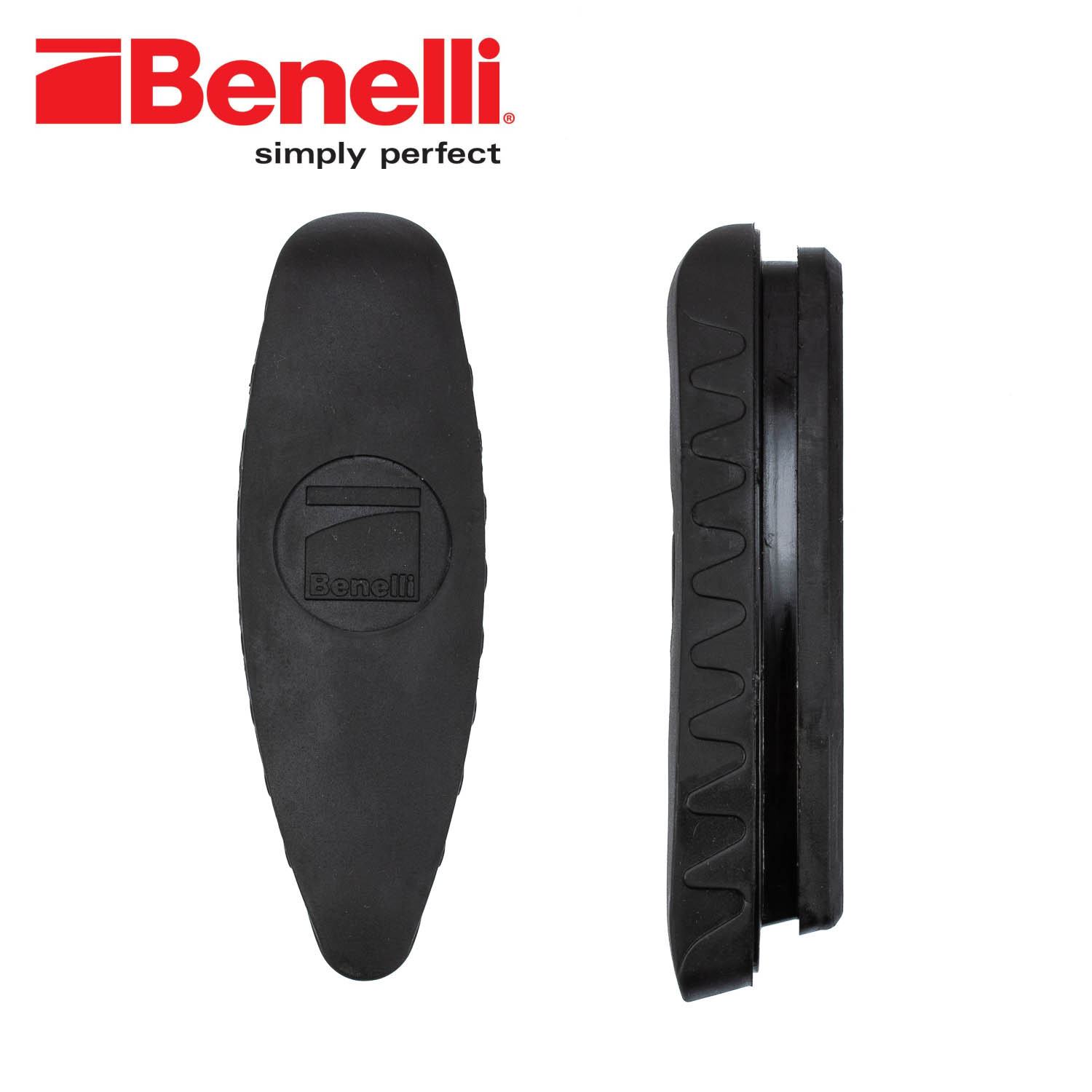

                Fair enough. First you have to determine if the stock is cuttable. Is it the same 2" in as it is at the end of the butt so the butt pad cac be reattached. A chop saw with a finish blade is your best bet at getting a good even cut....take the time to set up the stock so its an even cut top to bottom and front to back.
                Do a complete dry install run before you start...then do it again to make sure
                Have fun at the range.

                  I believe the stock gets wider at two inches. I saw some people using a limb saver grind to fit with a wood insert. I may have to go that route.
                  Now that I'm thinking about it, I can probably take off 1" and replace my recoil pad with a lower profile one and save about .5-1" that way... I'll have to play with it.
