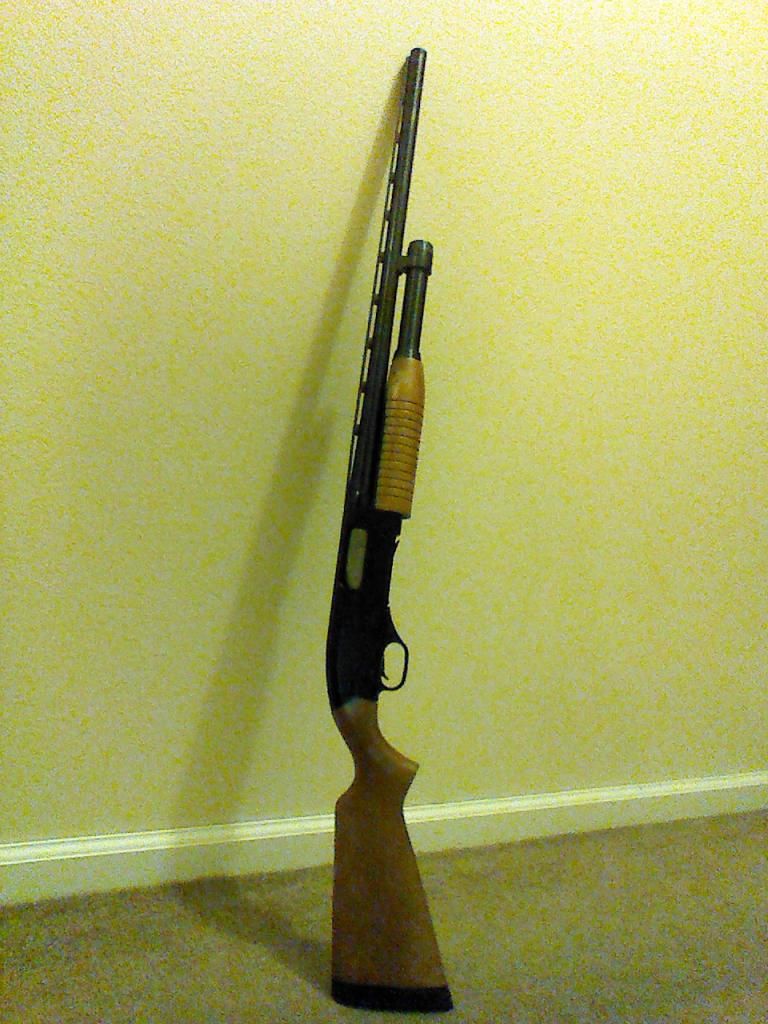

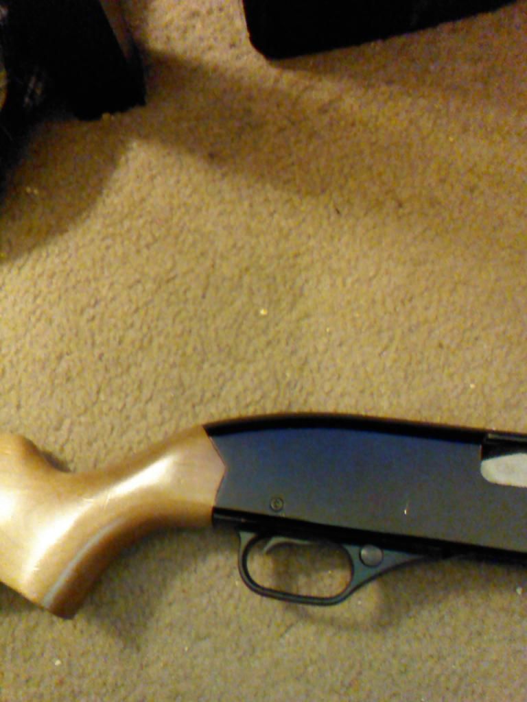

    Recently posted that I saved this Winchester 1300 20GA - but it has a snapped trigger.
    I am looking all over the web for the "trigger assembly" but I can only find it for 12 GA.
    I think that the 12GA is different from the 20, and my assembly does have a "20" stamped on the side.
    Any ideas? Any creative fixes for a busted trigger like this?

    I would start off by looking at the diagrams and parts list from gunpartscorp.com also known as numerich arms. if they have 2 different trigger assemblies for 12 and a 20 ...yes it's a different part they may have both but my guess is it's 1 trigger for both gauges. I would not try any quick fixes or JB Weld type solutions, it's your trigger. I hope that helps.

      I started messaging a bunch of eBay sellers and found someone who had a 20GA in stock and sold it to me for $80 shipped -
      Its more than I wanted to spend, as the Gun might not be worth twice that amount. Since its the full assembly I can just drop the part in.
