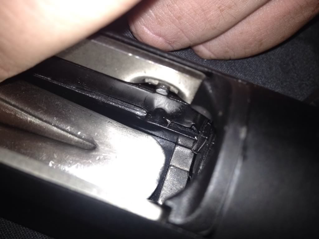

                  Found it was bound up on this notch pressed it down and it slammed into place
