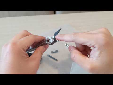

            I installed the Pro Lifter on my good ol Beretta 1301Tactical. It was a nice upgrade.
            I followed this video for the installation, and it was very helpful. As stated in the video; there were a couple tiny parts that tended to eject themselves across the room, so be careful when doing the installation.
              I should have looked this one up. I just took it apart and winged it but came to the same conclusions as this YouTuber did.
