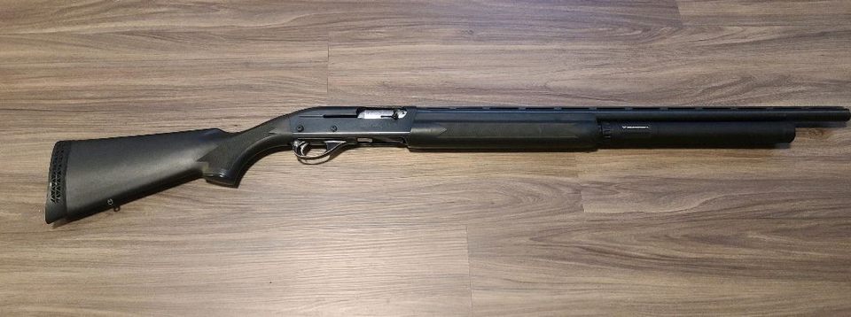

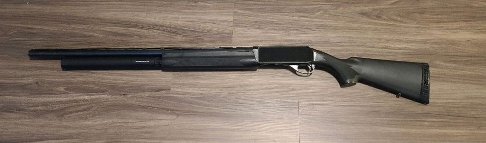

    Finally got to pick it up today!
    Was able to clean it up, and get the mag extension tube fitted, along with a side saddle that takes shotgun cards, which I already have a ton of.
    Still need to measure the barrel inner diameter to see if it's choked or not. There are no markings stating either way.
    Gave it a deep clean, tearing it all down. Although it was quite dirty, there's really not much wear anywhere. The mag tube doesn't have much wear, nor does the inside of the receiver. Everything function checks well. Replaced the o-ring and gas piston seals. It had the old style, replaced with the new style. Stoked to get out there and shoot some clays!
    Definitely want to do something about the carrier, that button is much more difficult to hit to load shells than I expected it to be. A competition carrier would be ideal IMO, but of course since I'm so late in the game they are nowhere to be found. There are a few EZ Loaders out there, but I don't much care for the look of it hanging out of the bottom, but it may be my only option.
    I think she turned out pretty good!
    From what I can tell, this appears to be a kind of a mashup parts build, but I'm ok with it as long as it works!
    I've only hand cycled with my dummy snap caps, but it seems to cycle just fine, won't know for sure until I get out there and shoot.
    Share your 1100's, love to see some cool builds! Anything else I should be doing to increase reliability?
