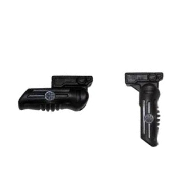

    He tried to sell my friend a CX4 Beretta vertical foregrip (see pic 2) but my friend wanted to ask me first if he should do it. He is set on buying it but wants to know what I thought first.
    I don't think this will even fit the shotgun. He said the salesguy suggested putting a rail or "clamp" on it! Arrgghh!

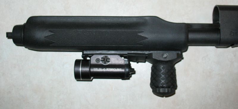

            How to mount it is pretty simple. Either buy a replacement forend, or be willing to drill some holes in the forend. Buy pretty much any 1913 rail that has holes in it, and screw the rail onto the forend. Mount the grip onto the rail like any other rail, and there you go. The only thing to watch out for is making sure the screws don't extend through the forend and interfere with any internals.
            Basically, it would look something like this, which is a factory Saiga forend with a rail screwed onto it. You don't have to make it stick down so much, that's just the particular rail that guy got. Or it would look like the rail on the bottom of this Remington 870 factory forend. (Neither are mine, just found it on the web)
            However, I don't think him putting a VFG on it will make a world of difference. Contrary to what the salesman said, it's not like he "should." It's just a different feel, a different way to handle and control it that depends largely on opinion. Then again, now that I think about it, it might allow him to always go to the spot that allows him to comfortably hold the shotgun, and never worry about his hand sliding forward and causing him to lose support of the shotgun.
