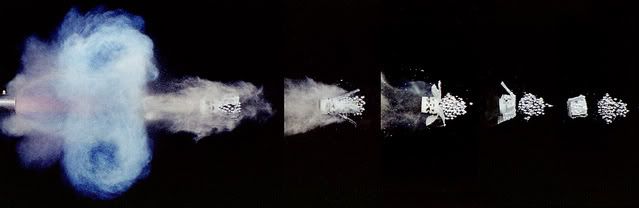

              Originally posted by ojisan
              What other home defense item creates a mushroom cloud as seen in the far left snap action photo?

                I had this picture as my wallpaper on my phone a couple weeks back.
                Amazing.

                  Uh Oh ...
                  Hope the preceding picture & commentary about "home defense item" & mushroom cloud does not re-ignite the "Birdshot - Buckshot & Slug" responses.
