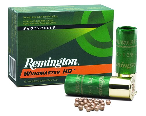

      They actually make 12GA ammo specifically home defense now days they come in two loadings - heavy-density BBs or Duplex load of No. 2 and No. 4 shot
      Shop premium #00 buckshot from Federal, Winchester, Remington, & more. Ideal for defense, hunting, and tactical applications. Various pellet counts & velocities
