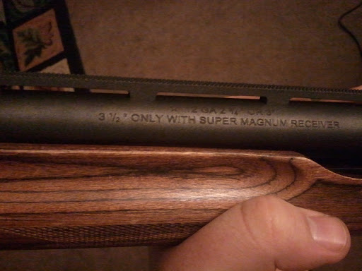

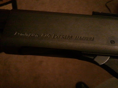

          Chris M
          • Jan 2007
          • 1771
          Originally posted by reidnez
          As long as your chamber is marked 3" or 3 1/2", no problem...
          How could I have forgotten that? Both the receiver AND the barrel have to be marked with "Magnum" (3") or "Super Magnum" (3.5")

                I guess I was assuming that there were non-magnum 870 express receivers, since mine specifically says "magnum" on it.
                  aippi
                  • 2302
                  Yep, it is confusing and these words are on there for marketing only. The ending letter in the serial number designates the receiver on all pre 2009 Remington shotguns. But gun makers realized that putting words like magnum on there sell guns. It was then the word Police or initials LE and today it is the word "Tactical".
                    While I understand what you're saying, "Police" and "Tactical" are slightly different for the main reason that there are Non-'Police' models of the various guns, and there are Non-'Tactical' versions.
                    Putting "Magnum" on the receiver is misleading, because it makes you think there are non-magnum versions of the same gun.
                    Oh well. Good to know, anyways.
                    I guess in saving costs, Remington manufactured all of their 870 express barrels (at least during certain years) barrels with 3.5" chambers, regardless of whether or not the receiver could cycle a 3.5" shell.
