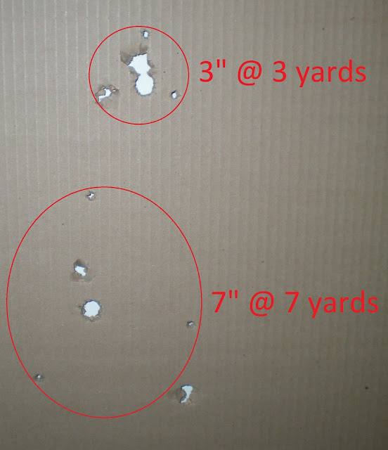

        I tried the new Winchester PDX (1 slug + 3 00 Buck pellets). It wasn't quite as bad as I thought, but it was a pretty crappy pattern. I shot a round at about 3 yards and at about 7 yards. It spreads about 1" per yard with the slug in the center and the three pellets forming a triangular doughnut pattern.

          Thanks for the pics. i saw this for the first time last week and was wondering what purpose it had. Now I know.

            The winchester pdx is designed for people who cant aim for s***
            The buck is supposed to spread into a triangle.

              I would go further than that. It is a patently reckless load. If it is ever used in HD, and the slug hits the assailant, and a stray pellet hurts somebody else or even "causes them emotional distress", I sincerely hope they get sued for every dime of punitive damages possible. The triangle formation basically minimizes any potential for those pellets to hit anything vital even if they all hit the target. One of the first things instructors tell people when patterning a shotgun is to swear off any load that forms a doughnut pattern. But worse than the doughnut pattern is the use of the slug as a spreading cone that makes it very likely that one or more pellets will be looking for grandma. It is a blatantly negligent round marketed to the clueless.
