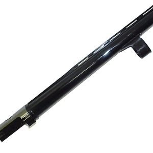

              I have a Browning A-5 Light 12 that my father bought sometime around 1957. I am leaving the original barrel alone so I can pass it on to my kids in it's original condition. Years ago, I was able to buy a Hastings barrel for it with choke tubes, but to my knowledge, they didn't make aftermarket A-5 barrel in 20 gauge.
              Do a google search for Browning A-5 barrels, I did and found this:
