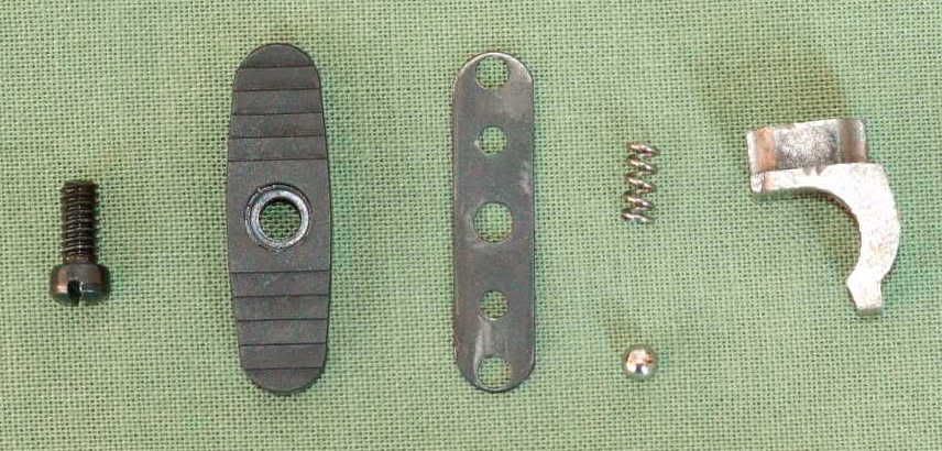

      No, you can't install a safety button yourself from what I can tell. The screw that is used is a one-way type - like what you see used on restroom metal stalls. Anyway I was mistaken, I took a close look last night with a bright flashlight and mine is an alloy as it is supposed to be according to Aimpro. The thing does look like it is polymer, but it is alloy. Eitherway, Aimpro says it is covered under warranty.

            Questions about repairing the safety on the Mossberg 500 series come up every so often. Since I had to take a buddy's 500A apart to fix the safety, I figured I'd take some pictures and write down what I've learned about this particular job. The location of the safety button on the 500 is...

              Hmm, it may help an older model 500. As I mentioned, my gun seems to have a non-removable screw. It is a slot screw that allows it to be installed but not backed out. Maybe there is a tool for this?? Anyway, it turns out I do have the alloy button, it just looks like polymer.

                      You can take the safety off. The one way screw is no big deal. Dealing with a one way screw is indeed something any gunsmith worth his weight could do, but it's not something the amateur couldn't get his brain wrapped around. And you really don't need a dremel either.
                      All you've got to do is back the screw out. One method is to take a hammer and punch and gently start the screw by peening it back. Place the punch (or even just a regular screwdriver) to a leverage point and apply pressure by peening gently with the hammer. The screw should start, and once it starts, with a little effort it will come out relatively easily with normal screwdriving, and maybe even by hand.
                      This is a basic tool skill, it doesn't require any special tool or special skill. Be gentle with it, be patient, and you won't damage anything. Once the screw starts, it's no harder than unscrewing any other screw.
