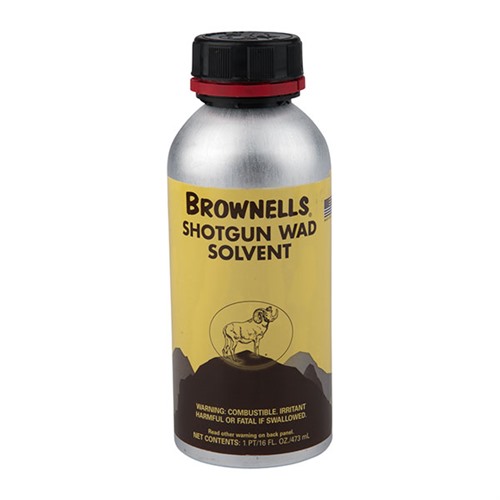

    Sounds like wad build up. Not a big deal. More common as many new guns are not as well machined and polished as they were decades ago.

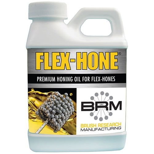

      There are hones to polish the barrel. Once clean, inspect the barrel. If rough, there are cheaper and more expensive methods to polish out the rough areas.
      As simple as wet sand sand paper and a wooden dowel with a slot cut into it to hold the paper and cutting oil.

                I was going to try that wad solvent first without honing first . I see it on my 870 as well pretty heavy build up. Don't think last owner kept up with cleaning much .

                  Honing to a fine polish is common in cowboy action to try to make the chamber area as slick as possible. That said, it has nothing to due with general cleaning or wad build up.
                  I'd use a wad cleaner and a brush.

                    OK, What you are seeing is plastic transferred from the wad as it goes down the barrel. This is common and happens to all levels of guns.
                    Rule #1 is that if you have Chrome Lined Barrels do not use any kind of abrasive to clean it out. That plastic wad solvent will do it just fine and not hurt the Chrome Lining which is supposed to keep plastic transfer to a minimum in the first place...
                    I am heading to the shop right now to use a Flex Hone on my new barrel that just got the forcing cone lengthened. It came out a little rough for my tastes and I can easily fix it.
                    The thing I use to clean my shotgun barrels most often is a "Bore Snake". I pull it thru the barrels after every shoot. I usually only fire 50-100 rounds at any given shoot so the plastic transfer is minimal and doesn't build up and the Wire Bristles on the Snake remove it in one or at most two strokes..
                    I have had problems getting plastic transfer out of the ports on some of my barrels. That is a PITB and I try to avoid it as much as possible. The Choke Tube Solvent cured that problem but it wasn't that easy to get all the little holes clean. The ports tend to act like a Cheese Grater and cut the wads producing little slivers of plastic which are hard to get rid of. But not impossible.

                        hermosabeach
                        • 19807
                        Correct
                        hone is to correct rough machining in non chrome lined bores
                        if the forcing cone is rough, it can trap plastic from the wad.
                        to keep cost down, manufacturers change the process.
                        forged parts and machines parts are now MIM- metal powder meted and formed into a solid.
                        surfaced that were polished and blued are now coated to hide scratches
                        bores that were polished like glass can be rough
                        WM
                        do you have a bore scope where you can film before polishing and after?
                        I also have a forcing cone reamer to clean up non chrome lined barrels and slightly smooth and lengthen the forcing cone.

                            I honed my new barrel after it came back from Vang Comp, The forcing cone was a little rougher than I like, so I went after it with my Flex Hones. Bummer was that my 400 grit hone is pretty much wore out so I had to do most of the work with the 800 grit Hone. The bore is like a mirror now !
                            I don't have a bore scope so I can't really show it but suffice to say it looks like it is Chrome Plated now. But it's not..
