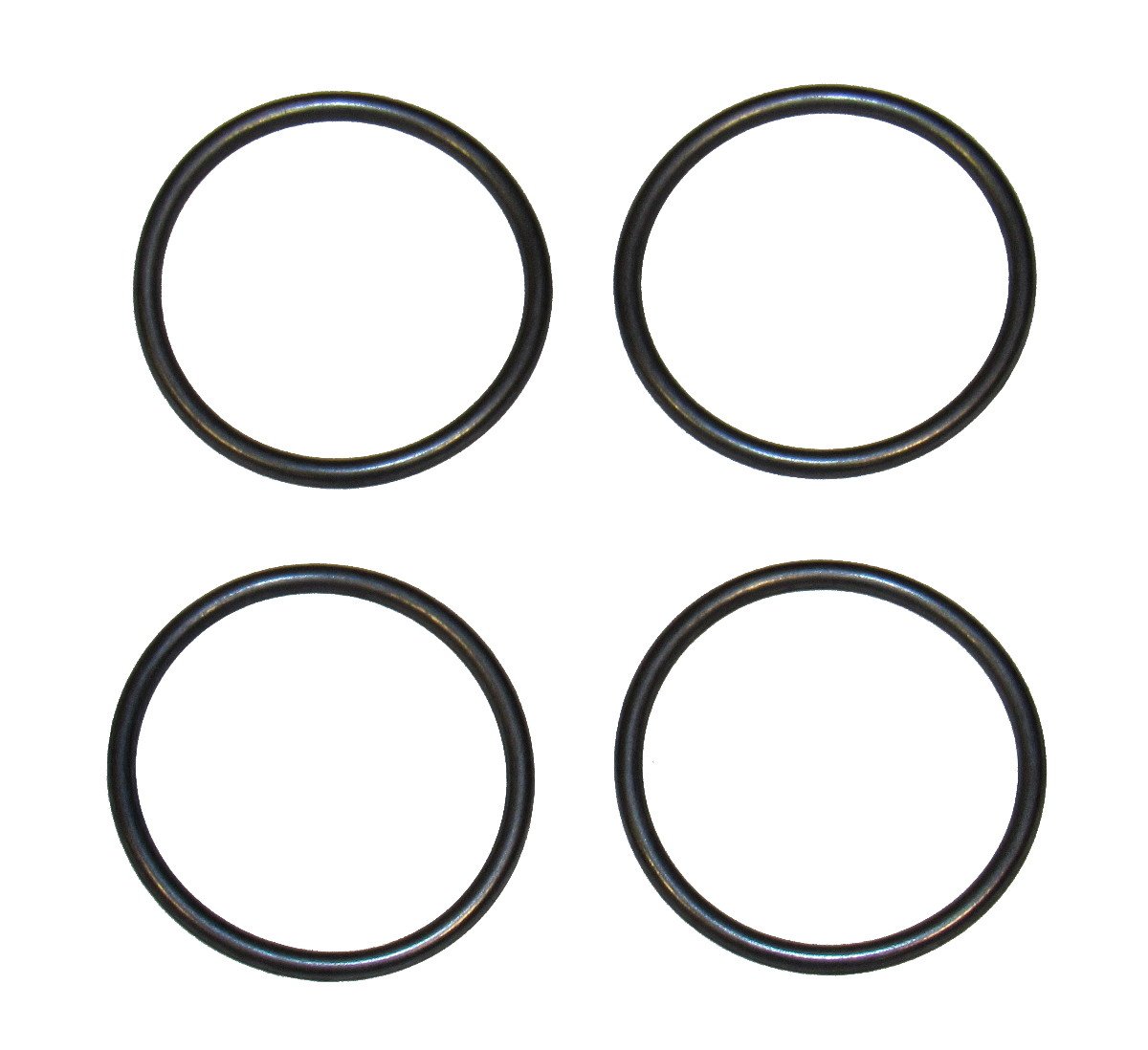

      Probably the O-ring.

        I would agree. I buy mine from a local hydraulic parts dealer and always specify "Viton" as the material. Viton is a fluoropolymer with a high temperature rating and great resistance to oils and gun cleaning chemicals.

          Try a new metal gas piston ring and O-ring. Maybe also twist by hand the appropriate sized drill bit in the gas port and make sure it is not caked up with carbon.
