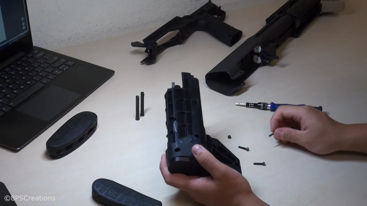

    I am seeking beta testers for a 3D-printed Kel Tec KSG/KS7 Buttpad Adapter I have created. The beta testers would need to test the fitment, function, and durability of the adapter.
    Background
    KSG and KS7 owners have only two aftermarket options for recoil pads: the Kel Tec Extended Buttpad or a Limbsaver/Pachmayr Slip-On. The problem with the OEM Kel Tec Extended Buttpad is that it does not reduce the felt recoil as much as the Limbsaver/Pachmayr. The Slip-On recoil pad, while comfortable, is unsightly. This adapter offers a flat surface behind the KSG/KS7 stock that allows users to attach a Limbsaver Airtech precision-fit recoil pad, which is more permanent than the Slip-On and also makes shooting much more comfortable.
    Description
    The 3D-printed adapter is a direct drop-in adapter for the stock KSG/KS7 buttpad. It is printed with TPU plastic with 20% infill and is flexible. Installation is simple. The adapter is not a recoil pad.
    Requirements
    1. You have access to a Kel Tec KSG/KS7 (any generation).
    2. You are willing to purchase a Limbsaver Airtech precision-fit recoil pad (or similar flat-sided recoil pad) and attach using superglue or epoxy it to the adapter.
    3. You are willing to provide feedback after using the adapter.
    FAQ
    1. Which Limbsaver recoil pads will fit?
    The Limbsaver 10802 is the one I've personally tested. But it seems like the 10801, 10806, 10808, and 10814 are also similar in size and may be used.
    2. How do I attach the recoil pad to the adapter?
    Currently the easiest way is to super glue or epoxy the two pieces together. Although I am exploring other viable options. Do not drill or otherwise puncture the adapter.
    Pictured: Gen 2 KSG with the adapter installed and Limbsaver Airtech precision-fit 10802 superglued onto it.
    Post any questions in this thread and I will answer them.
    Interested? PM me and will we can talk about mailing you the adapter and get started!

    Still looking for testers! Here's an instructional video on the installation. Product overview video is still in the making.
    Learn how to install the 8PSCreations KSG Buttpad Adapter and a recoil pad.
