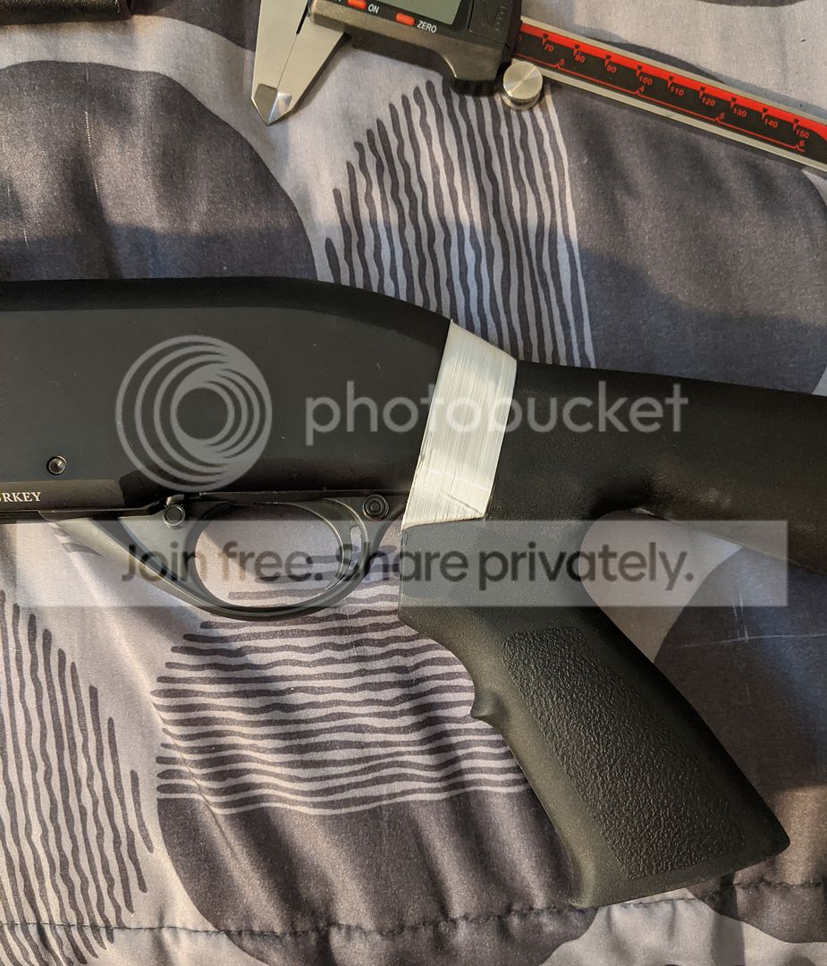

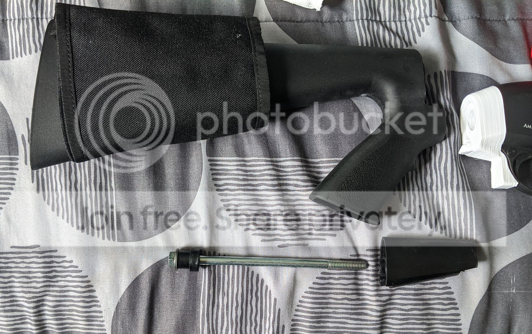

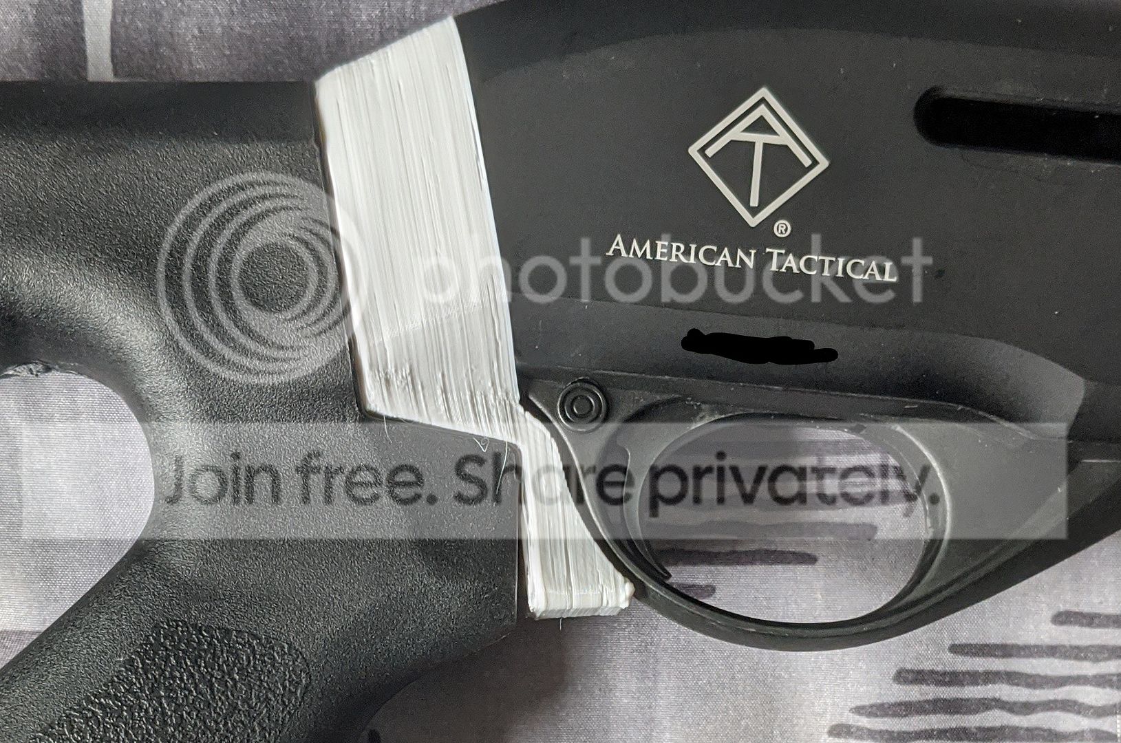

    When I bought the ATI TAC SX2 shotgun back in over 5 years ago, I remember wanting to get a pistol grip for it but nothing was available. I had plans to design one but never got around to it. Now I took the time and designed one and made it with my 3d Printer. Let me know what you all think. It used the ATI pistol grip kit PN: 118-ATI-SPG0100 along with a longer bolt to hold it all together. Pictures show printed in white PLA, im moving forward to print with black ABS or Carbon fiber ABS depending on testing What yall think about it?
    The first Revision(proof of concept)
    The Updated Version(removes gaps)
    The Kit Picture

      I used Solidworks for design and I printed using Cura and Robo 3DR1 Plus.
      Modeling the strength of a 3D printed parts is often hard due to the nature of 3d printing material. I know from a heat perspective the final version will not be PLA (as pictured) due to warping. Most gun plastics are made using ABS. The main concern with ABS in this application is the impact strength since it will not see tension applications. I plan to do some impact testing using the provided extra adapters that came with the kit as a baseline. If my part survives the same impact then I will deem it good enough.
