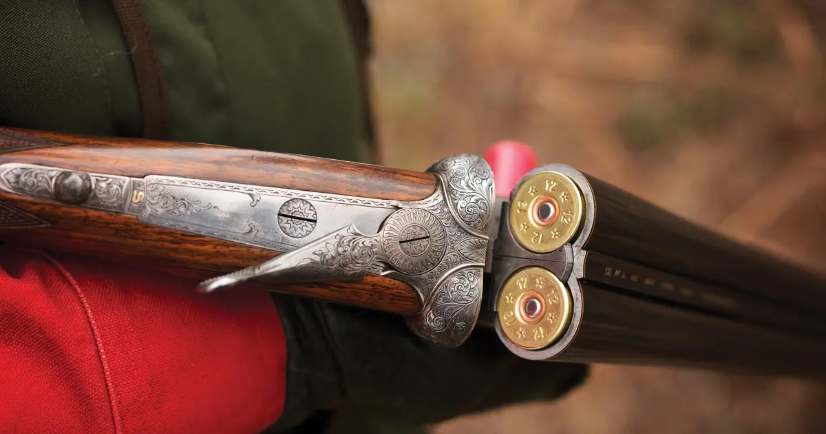

                              Here is an article from the Shooting Sportsman on the 2” game gun.
