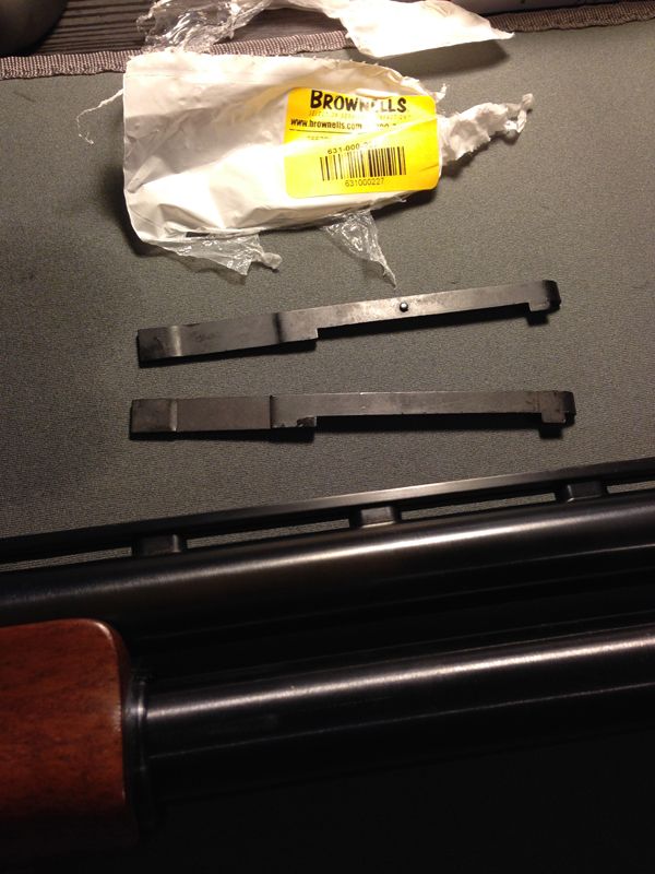

              I had this problem as well (http://www.calguns.net/calgunforum/s...d.php?t=997876). It turned out that I had a defective cartridge stop. The replacement is on top, and the defective one is on the bottom. Note the lack of the pin on the bad one - that not being there allowed the stop to move on recoil, and drop rounds out of the mag tube.
                  Strange but neither my wife's original stop, the replacement Mossberg sent for her .410 nor the 20G stop they mistakenly sent as well had that pin on them.
                  The stop can't move rearwards under recoil since the rear of it butts against the rear of the slot it is placed in. The issue with my wife's (and possibly the OP's) was that there is too little engagement on the shell's rim and under recoil the stop will bounce out of the way, allowing the shell to exit the magazine and eject through the loading port since the shell lifter hasn't moved into position yet.
                  The solution was to VERY CAREFULLY bend the tip of the stop in front of the activation lug (the part poking out below the tip) slightly inward. Too far and it WILL snap, hence the replacements Mossberg sent me.
                  Once I did this my auto-eject problems totally ceased.
                    essjay
                    • Jun 2014
                    • 1429
                    "Defective" probably wasn't the right term. Regardless, the replacement part I got from Brownell's had the nub on there, and it did the trick. I had previously tried bending the original part, and it didn't fix the problem on any kind of consistent basis, sadly.
                      Where were you "bending" it? You need to bend it right at the tip and not further down along it's length.
                      Before I found this out I had the same inconsistent results you mention.
                        essjay
                        • Jun 2014
                        • 1429
                        Yeah, that's probably it, then. I'd say it was about 1/8" to 1/6" past the tip.
