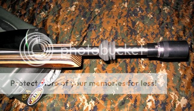

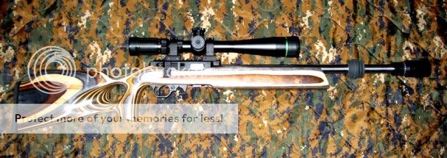

Believe it or not, with the 10-22, you could put one together for less than $600. The secret is in the barrel and the ammo. I built up one for a buddy, $270 for the rifle, $210 for the barrel, trigger and bolt work done by ourselves and an additional $100 for a Simmons rimfire scope and additional parts like extractor, buffer and firing pin. It was only a 3x9 scope but he was able to cover his 5 shot 50 yard groups with a dime using Wolf Match Target ammo. It does take some skilled work on your part but it can be done.sigpic

Cusco, the added weight may seem like a bit but it really helps stabilize and steady the rifle when in the offhand position and seems to settle when in a supported position such as sitting or prone. The weight resists movement and slows down the barrel sway. My Service Rifle AR is 16 lbs. Sure, there is a limit and probably would make for a long day if used for hunting to use bull barrels on hunting rifles but for precision shooters, there is usually no better choice.sigpic

What is the side lever on that "10/22" ???Comment
